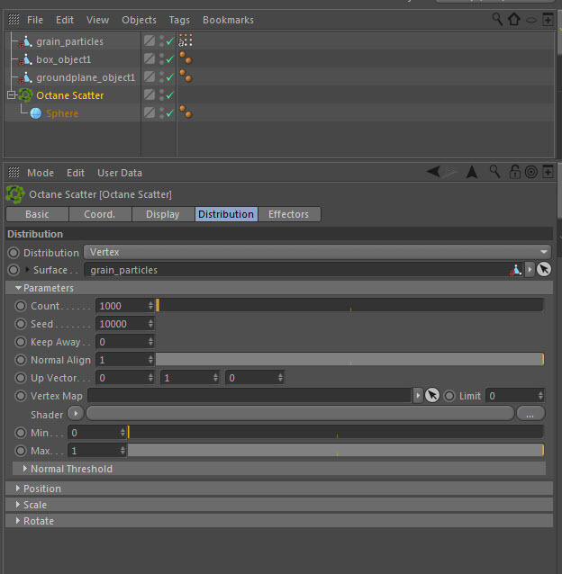

Here is another alternative way with scatter object. But TP support is on table. I'll need some advice about workflow.

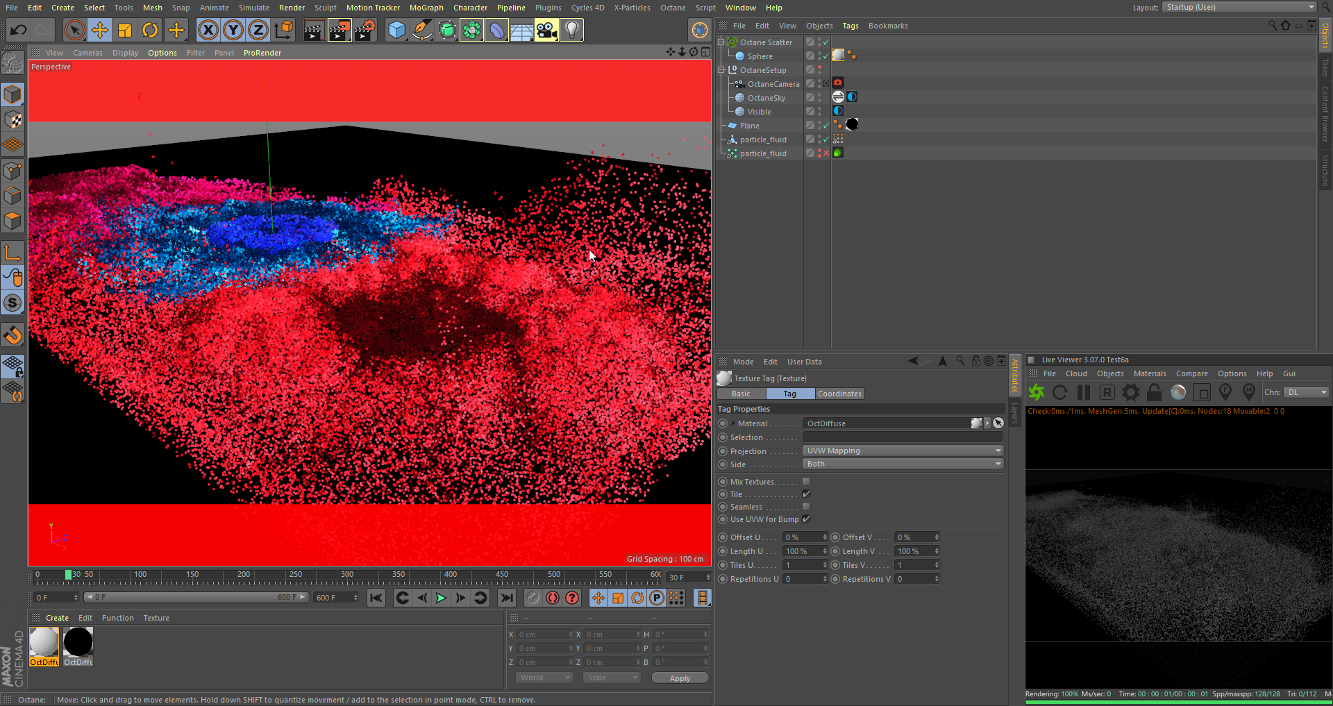

Hi, any update on this? Scattering help to control the size of particles but can't get that color data to work (plugin in vertex map houdini color data as diffuse) :(

jmd wrote:Hi, any update on this? Scattering help to control the size of particles but can't get that color data to work (plugin in vertex map houdini color data as diffuse) :(
Please follow your posts in a shorter timerange! I have a lot of topics to follow while working on plugins.
Could you please send your latest test scene with alembic? I'll check it.
