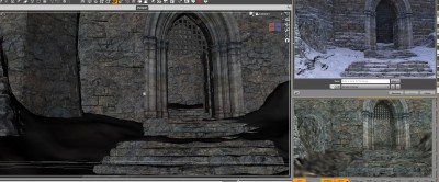

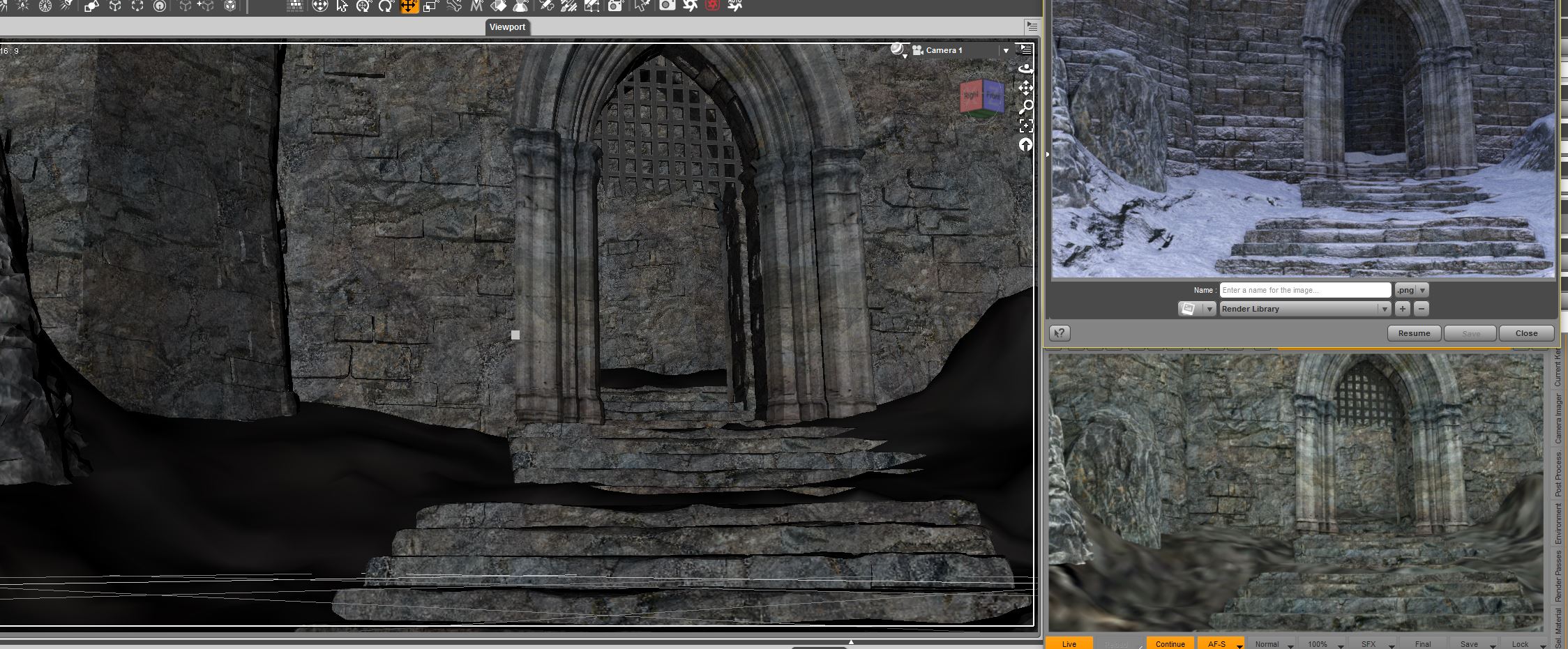

more and more i have issues with new product which no longer have 3DL Materials within.
And i really think that it will be an issue in future.
Here is an example with the new Wintercastle by Stonemason :
Viewport and Octane are looking weird. The Iray render top right corner looks awesome.
To be honest - i do not want to miss future products of Stonemason. But i already had some issues with his Urban Sprawl 3 very similar to this.
Anything that could be done ?

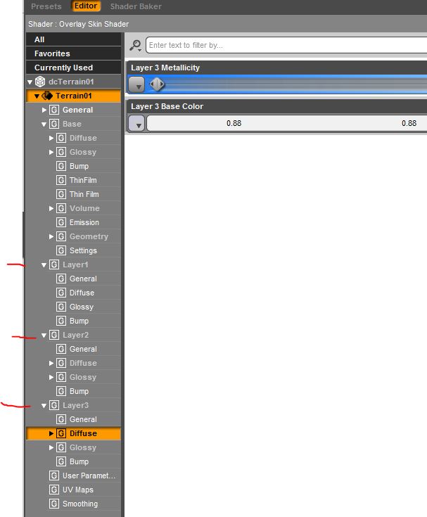

In that case here it seems like the materials have different layers. The snow layers are ignored. This is surface tab of the ground.
In more in half of the new products there are no 3DL materials more included and right now OCDS is not able to handle all kinds of Iray Mats. For users it does not care on which site the issue is - as long you can not use more and more if the new content it will be an issue for octane users.

Octane does not support layers (although you can achieve similar effects with material mixes). I would need to see all the inputs into the layers to determine if this could be replicated in Octane or not. However it would be difficult to make converting IRay layered materials to Octane materials an automatic process. The up-coming Open Shader Language feature of Octane 3.10 may provide some solutions in this area though.In that case here it seems like the materials have different layers.

It is not only that the layers are ignored. Also the UV Transforms are ignored. So i have to "trial and error" a bit. Reminds me very similar to the Terradome 3 issue.
So any chance that transforms are correctly read anyhow ?
And why it is not possible to recognize layered textures and create mixed materials from it ?

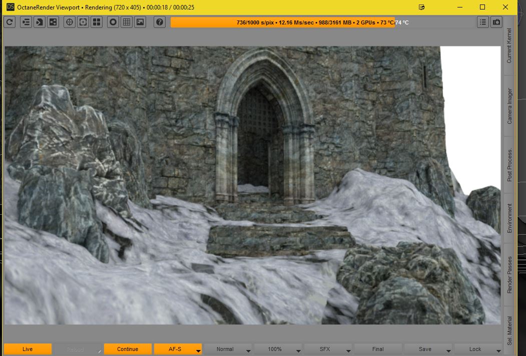

Assigning the snow mats from livedb looks not good.DrHemulen wrote:Have you tried just applying a snow material from the liveDB?
It just assign snow then to tho whole terrain. But in original it has stone covered with snow. I do not know if i can assign snow material just as a second material.
