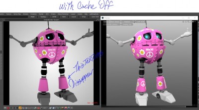

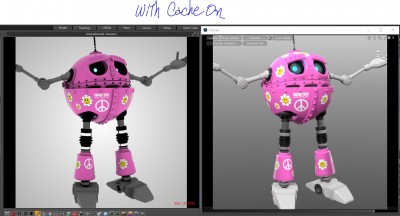

actually I verified what you said and curiously when I turned the render cache off some textures dissappear, I have been checking all the file and after all day breaking my head I decided to take only a leg of the robot wher Im having a problem, export it to a clean file, delete all textures and materials and load it into the plugin, I discover that I still got the error too much uv´s on one mesh and when I applied the texture the behaviour was the same, the textures show ok in modo renderer but not in Octane.
I went to your video about multiple UV´s and saw the issue is not exactly that one (The behaviour is the same). So I break the leg (that has more than one mesh combined in one modo mesh) and separated it to a new modo mesh with an exclusive UV for it, and it works.
So it seems that we need to have only one mesh and one UV in each mesh to be able to render in octane is this right? Of course I have all the combined mesh with their exclusive UV islands and separate UV´s per material base and it renders perfectly in modo, but I'm concluding that is not possible to render this way in Octane.
