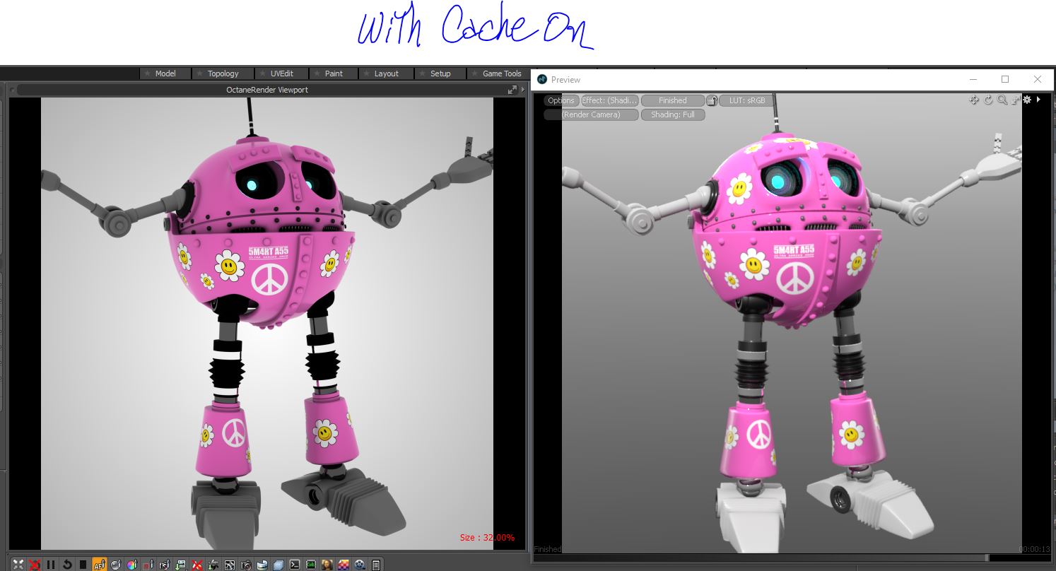

Hello, I bought Octane a few days ago and I'm very glad I did, is awesome. Watching some Paul's videos, and other tutorials, and reading a lot here, I'm getting there on the use of the stand alone and the modo plug in. I opened a scene i have already created in modo and because it has 2 robots that were created from the same one,; they have very similar names on their parts and on their UV's. So I have lots of this pesky "too much uvs on one part" and "can't find the uv index...". Reading here in the forums I understood that Octane looks for UV' indexes in a progrressive way and this causes those erros, but curiously lots of the textures load correctly on the octane plugin even getting the errors. The thing is that I cutted the parts of UV's that were creating the conflicts, created new UV's on the appropriate positions, and assigned the new UV's to the parts that need it, and it doesen't work. i see the mapping correctly when I do a render preview in Modo but no matter what I do I can't get them to work in octane. Im sure that Im doing something wrong but cant figure out what is it. i have reloaded the scene many times, triple checked the names and corresponding UV's and nothing.

Hi Victor - make sure you have Preferences->Use Modo Render Cache off, since it will stop UV's being sent to Octane if there is no image map in the Shader Tree group for the material.
Also - make sure you are running a recent release (3.4.4.114 or later).
To debug this, try rendering the UV Coordinates pass (and set the UV Coordinate Selection) - that will show you exactly what areas are UV'ed, for each map. render out the Material ID pass too, to make your the polygons have the right material tag. Also check the Modo event log for clues. If moment of that works, feel free to send me the scene and I can take a look.

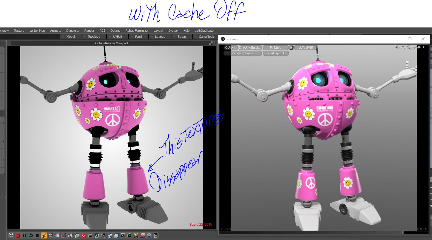

Hello Paul, thank you for your repply,
actually I verified what you said and curiously when I turned the render cache off some textures dissappear, I have been checking all the file and after all day breaking my head I decided to take only a leg of the robot wher Im having a problem, export it to a clean file, delete all textures and materials and load it into the plugin, I discover that I still got the error too much uv´s on one mesh and when I applied the texture the behaviour was the same, the textures show ok in modo renderer but not in Octane.
I went to your video about multiple UV´s and saw the issue is not exactly that one (The behaviour is the same). So I break the leg (that has more than one mesh combined in one modo mesh) and separated it to a new modo mesh with an exclusive UV for it, and it works.
So it seems that we need to have only one mesh and one UV in each mesh to be able to render in octane is this right? Of course I have all the combined mesh with their exclusive UV islands and separate UV´s per material base and it renders perfectly in modo, but I'm concluding that is not possible to render this way in Octane.
