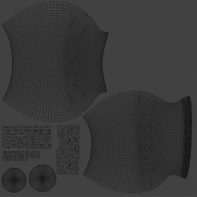

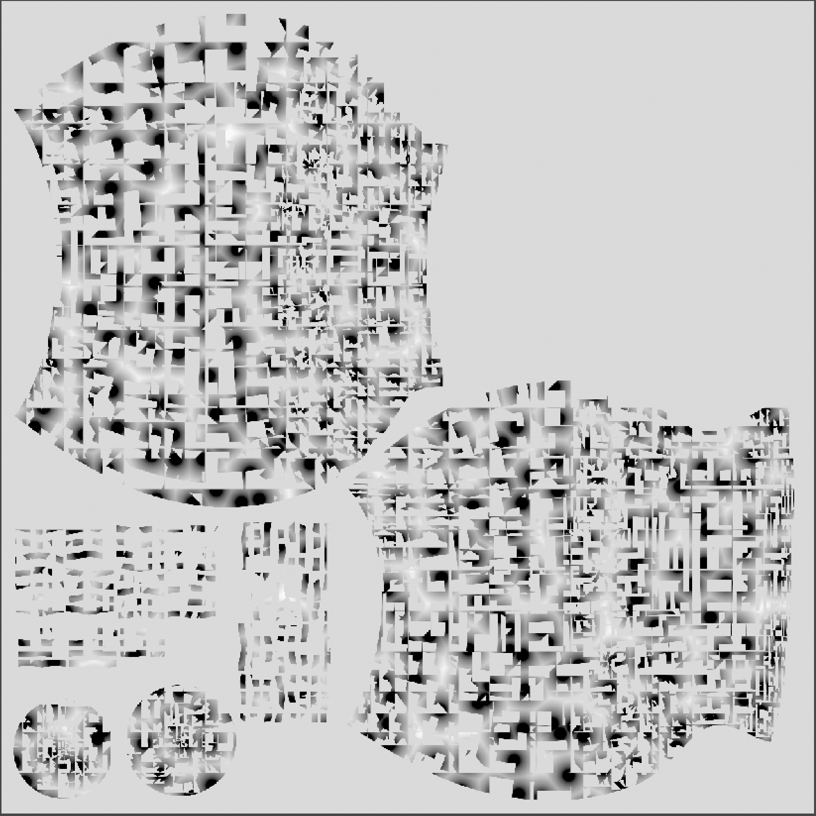

This is my first time trying to bake a texture, and I keep getting all kinds of crazy mess when it bakes. Here is what I'm getting:

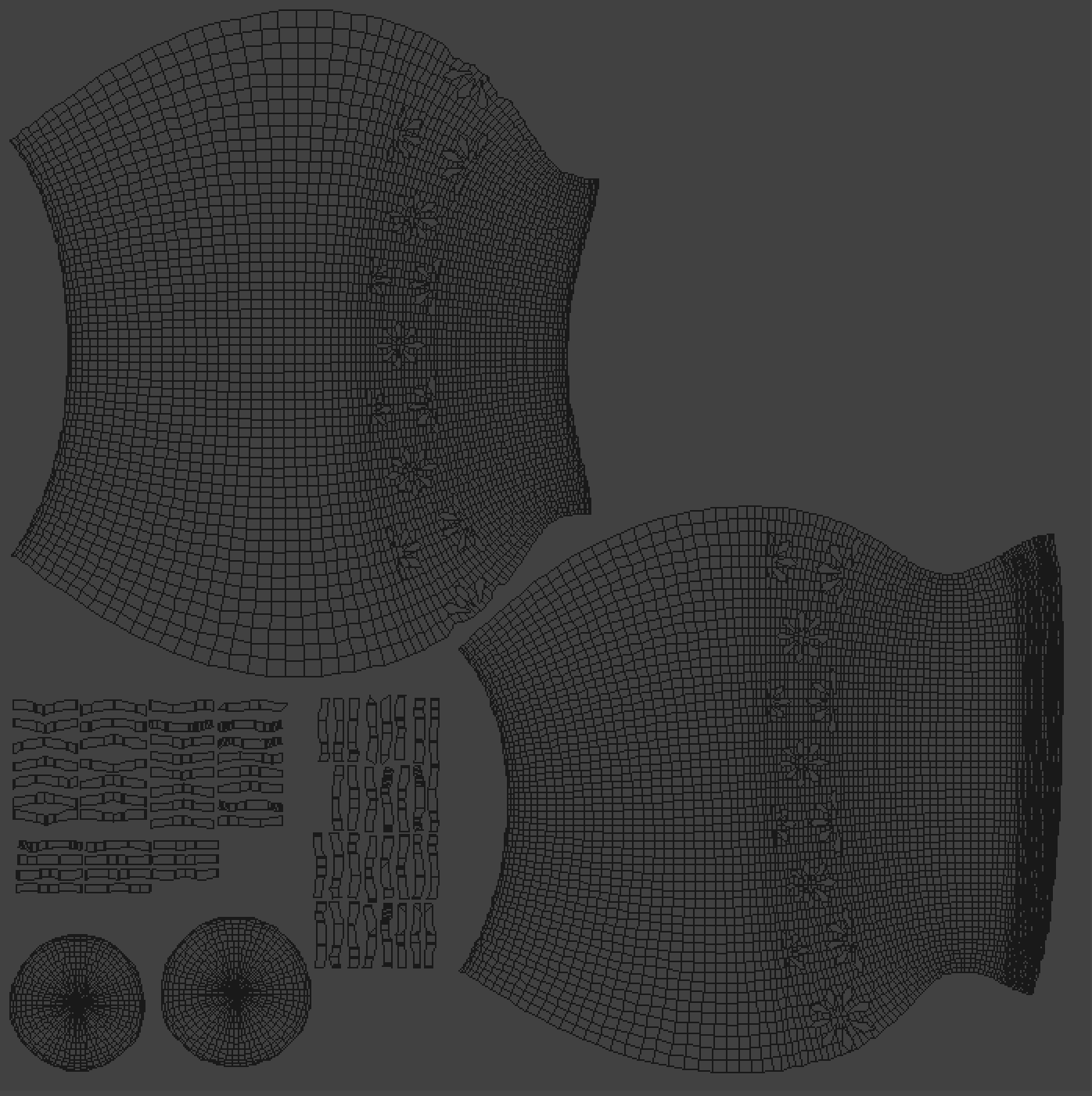

Here are my UVs:
Scene is attached. I've redone the UVs a few times. Can someone help me understand what I'm doing wrong. Thanks

Check your baking groups, you are quite likely baking two groups which UVs overlap so that's why the output looks that way.
Walkinghome6
Posts: 18
Joined: Wed Jul 01, 2015 6:55 pm
Location: Nashville, TN
I'm so pissed right now. I've been working with this for a couple of hours now. I thought I only had one UV in the scene. I forgot a had a backup Null turned off, full of all kinds of objects. I guess you gotta learn some how. Thanks.
