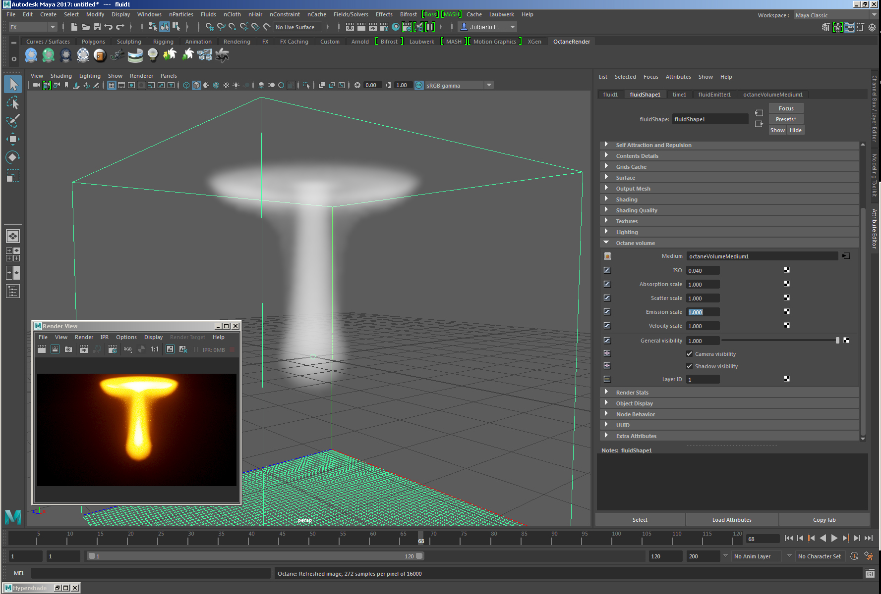

Maskeline wrote:Is there any documentation on the new features in the Maya plugin?
For example; I do not know how to assign an octane shader to a fluid, or how to build fog ...
For users who do not use the standalone, it would be very interesting to have some documentation on how Octane works in Maya.
For fluids pretty simple...here a screen attach.So far I love the way is setup now simple and straight forward, I guess for the fog to option attach on the "Octane Options" also for the Sunsky is a medium option to. :D
But sometimes I have a offset on transform and a bit hard to get the scale...I'm still looking at

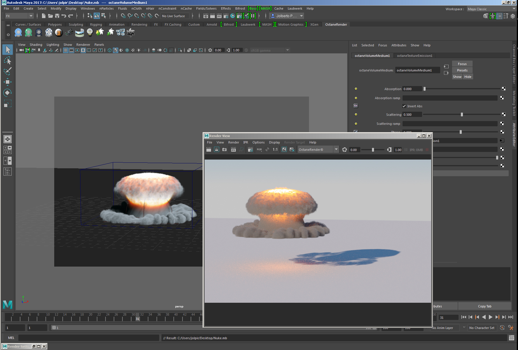

Jolbertoquini
Posts: 1067
Joined: Sun Aug 31, 2014 7:08 am
Location: London
Hi Guys,
Here the strange offset on the file with Fluids, Also I'm struggle to get the same amount of details as the Maya fluid on Octane I don't know if is the step? or the rescale scene, I know is not easy but would be great to recognize the scene scale on the render setting and compensate then.
I attach a screen and the Maya scene this the default Nuke my scene included in Maya. I may doing something complete wrong so please advises?

Thanks for the heads up on the setup it works fine since there no doc about it ;)
