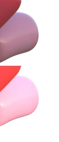

I'm trying to figure out a pretty urgent problem. I have one computer I've been using to setup a render which has an nvidia k6000 GPU, but the project is huge and requires my other computer which has 4 Titan z' inside. The issue I'm running into is that when I open the exact same file on both machines the output looks totally different from one to the other. I've attached a snippet from the two images so you can see what I mean. The top is from the Titan Z and the both from the k6000...supposed to look like the bottom one.
Anyone ever run into this?! Help!

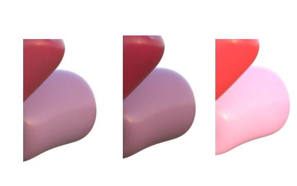

Would love some insight into why this might be happening if anyone has any thoughts. Could it be the color profiles from computer to computer? Would the computers color profile determine how octane is rendering out of C4D? I did another render from a 980ti machine and got a slightly different variation again. The images below go from left to right as, Titan Z machine, 980 ti, and then the original k6000 machine.
Posts: 16068
Location: Türkiye
Put a sample scene+render output and let's check. Are you sure all plugins are same version?
Also check for cohorent ratio. It causes color changes until some samples.
Ibycus
Posts: 84
Joined: Wed Jul 08, 2015 9:52 pm
ARGH! Hahaa
Yes, it was the version number! The k6000 was running version 3.03.03R1 and the Titan Z machine was running 3.03.01R5. Amazing how big of a color difference there is between those two versions.

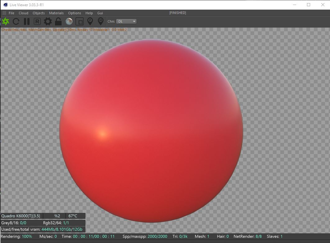

this is the output I am getting from that file with version 3.03.3-R1

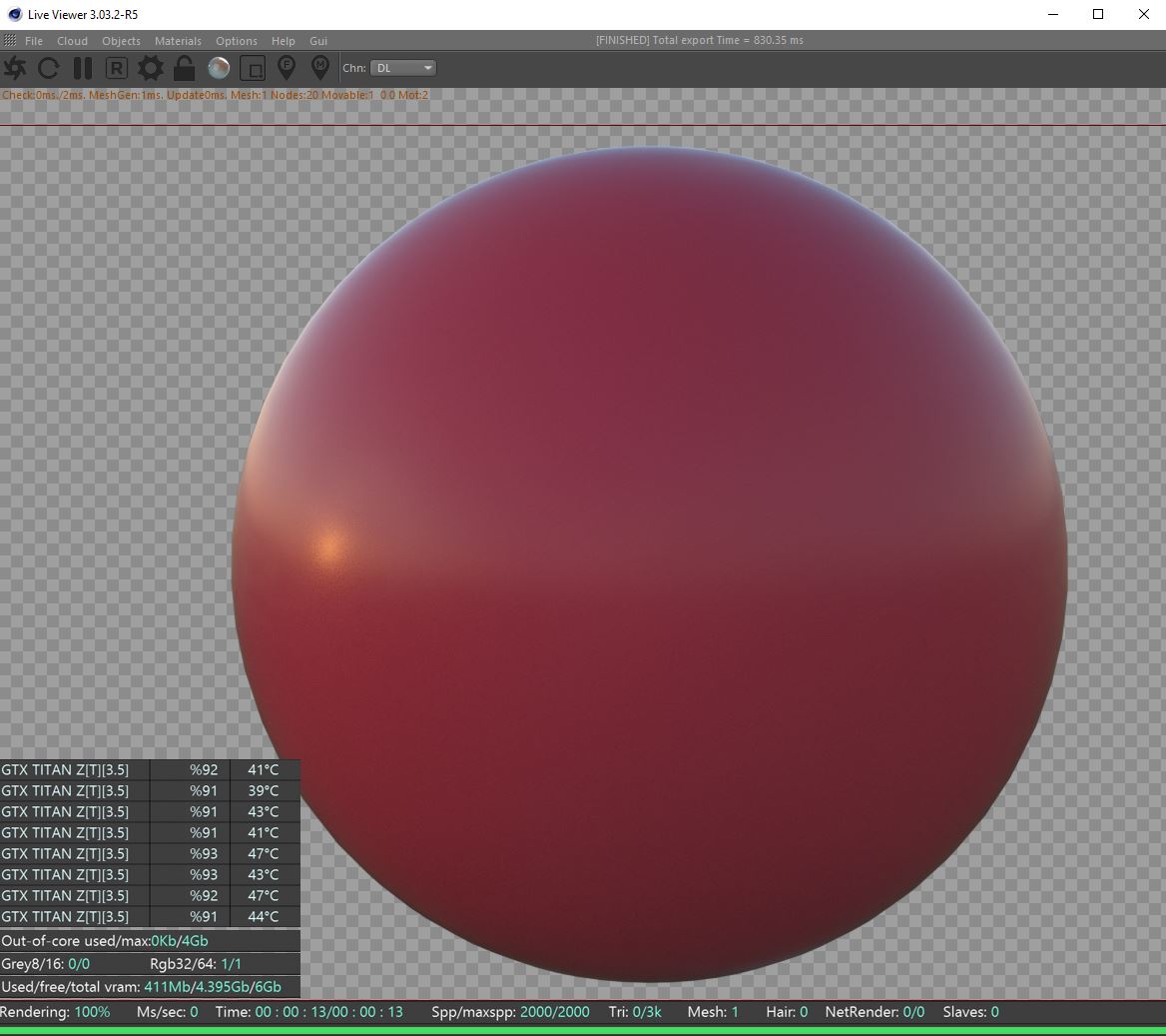

and the color output I'm getting from that same file with version 3.03.2-R5 on the other machine.
