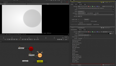

Hello. I am loving Octane for Nuke. I am having an issue, though, with motion blur. I can't get it to work. It does work in the standalone, however. I also can't seem to get a motion vector pass out of it.
Could this be a bug? I think I've tried everything.

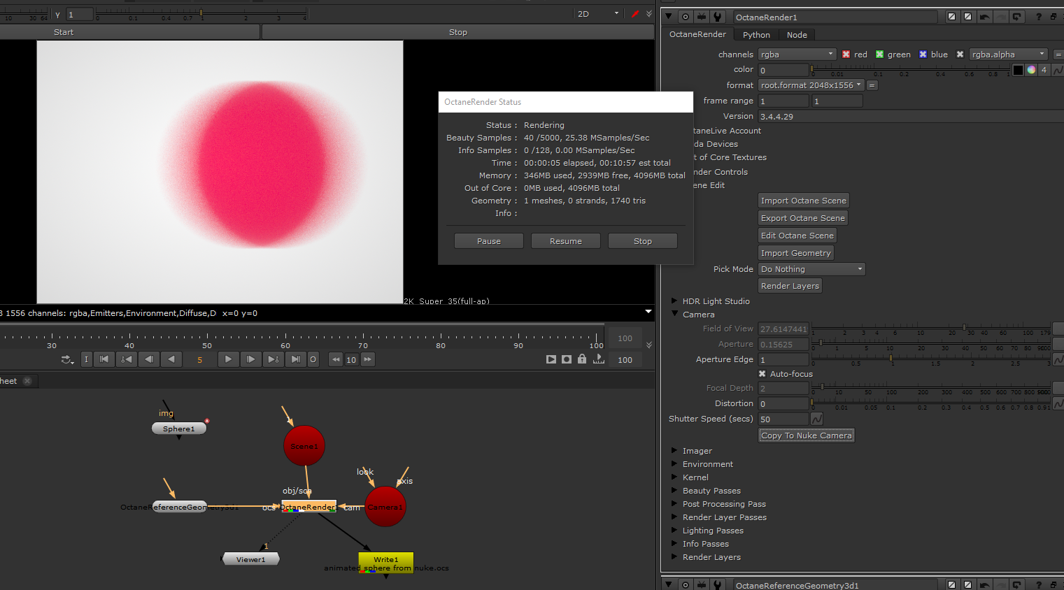

Motion blur is not directly available for Nuke 3d geo items. So to get motion blur on a Sphere item you need to export it to an OCS and then import it as a reference item, as foillows:

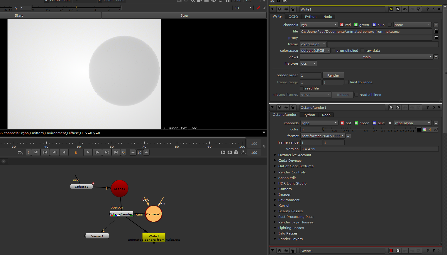

1) Add a Write node to the Nuke node graph and plug the OctaneRender node into it. Then set the "file" to temp.ocs and the "file type" to OCS. Click Render to output the sphere to the OCS file.
2) Add an OctaneReferenceGeometry3d node, and set the ORBX/OCS to the file output from 1). Plug this node into the OctaneRender node, and unplug the sphere from the Scene node.
3) Start rendering, and set the Shutter Speed to the applicable number of milliseconds (the "Shutter Speed (secs)" label should read "Shutter Speed (msecs)", which I will fix in the next release.

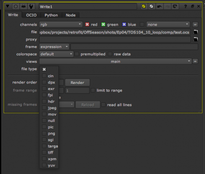

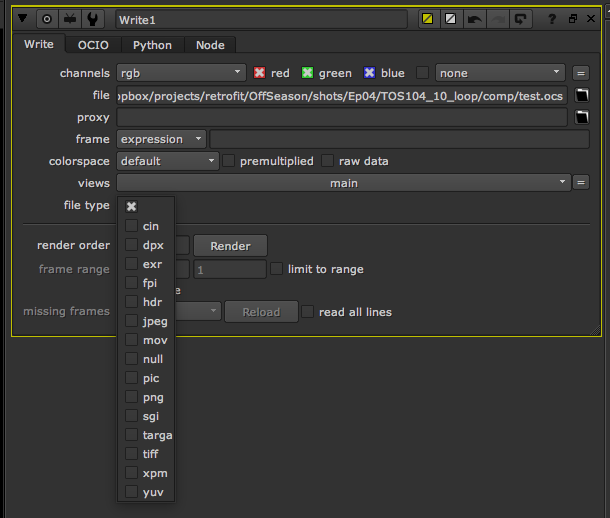

Ah. This brings me to the next problem that I'm having. When I try to write a .ocs file form a write node I get the error: "no plugin named "ocsWriter" found."
The file type is also not selectable from the menu.
face_off
Posts: 15813
Location: Adelaide, Australia
Thanks Jason - what version of the plugin and Nuke are you using pls? Are you on Windows, OSX or Linux? The OCS file save format is added to the Write node with the C:\Program Files\Common Files\NUKE\10.0\plugins\OctaneRender.bundle\ocsWriter.dll file (for Nuke10 on Windows) - is that file present on your system?
