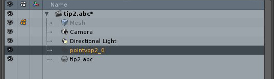

Hi Paul,
I must be missing something here. See the attached image of the item list, the last two entry's in the list are for the alembic, there is no mesh layer.
Darren
Darren

File->Open->tip2.abc. This results in a mesh item where you can tick the Render Curves checkbox.I must be missing something here. See the attached image of the item list, the last two entry's in the list are for the alembic, there is no mesh layer.

Hi Paul,
OK, tried via Open / File and it brings up the same options as Import which I was using. I can indeed bring in a single frame of the alembic animation this way, as you say it gets imported as a mesh layer with the render curves option.
However I need to bring it in as an animated sequence, so when I Open/Import it and select Import All Frames in the Alembic Load Options, it comes in as a non mesh layer, as in the previous screen grab I posted.
So as far as I can tell the problem remains, there is no way to load in an animated alembic sequence and have it render via the plugin? As mentioned the behaviour in stand-alone is as expected, it brings in the alembic per-frame with no bother.
Does that make sense?
Thanks,
Darren
Thanks,
Darren
