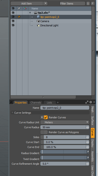

face_off
Posts: 15761
Location: Adelaide, Australia
I must be missing something here. See the attached image of the item list, the last two entry's in the list are for the alembic, there is no mesh layer.
File->Open->tip2.abc. This results in a mesh item where you can tick the Render Curves checkbox.
Paul
TheImageFaculty
Posts: 72
Joined: Thu Feb 25, 2016 8:49 am
Hi Paul,
OK, tried via Open / File and it brings up the same options as Import which I was using. I can indeed bring in a single frame of the alembic animation this way, as you say it gets imported as a mesh layer with the render curves option.
However I need to bring it in as an animated sequence, so when I Open/Import it and select Import All Frames in the Alembic Load Options, it comes in as a non mesh layer, as in the previous screen grab I posted.
So as far as I can tell the problem remains, there is no way to load in an animated alembic sequence and have it render via the plugin? As mentioned the behaviour in stand-alone is as expected, it brings in the alembic per-frame with no bother.
Does that make sense?
Thanks,
Darren
