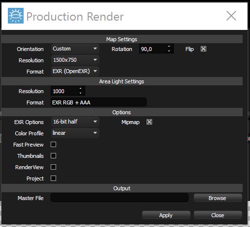

I have discovered that the problem of wrong light direction of reflection and light is due to a change from Octane standalone 3.04.4 (see the change) the last one cause the problem. Fellow at HDRLS confirm me now and sent a request to Otoy to fix the problem.
The workaround is to change the setup of render as follow:
select Custom instead of C4D and then set 90° and check Flip
