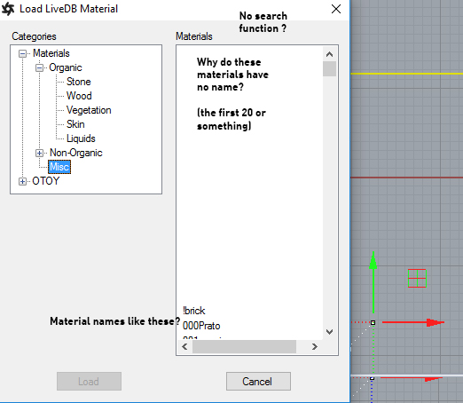

Thanks for your reply's. You must admit that the liveDB material browser is below average compared to other render suits. Or do you think this is the best thinkable interface for a material browser?
See attachment.:
- funny material names.
- no search..
- I have a fast interent connection. But still the material preview has a slight delay. And as there is no search function, I have to go trough the whole list of funny material names every time. And every materials has to be loaded, so all in all, that gets pretty slow..
See attached image too.
Funny file names and bad live db browser
face_off
Posts: 15767
Location: Adelaide, Australia
Those are blank material names. You can see them in the Octane Standalone LiveDb browser too.
