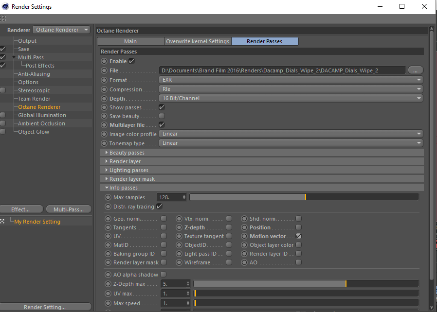

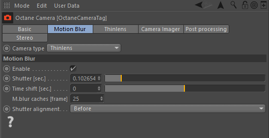

I've just installed the latest build of Octane for C4D and still getting a black frame for my Motion vector pass.
I've attached screen grabs of my settings - both Render and Camera tag - have I missed something?

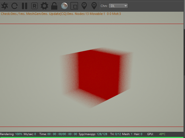

When I disable the motion vector pass I get motion blur in my image and in the Live viewer. It's just when I enable the individual pass that it doesn't seem to render any of the motion vector pass - just a black screen.

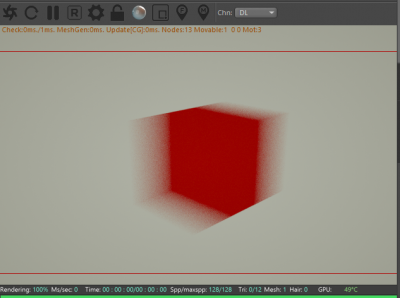

Here's some grabs: (can't post stills of my project) but here's me just testing it on a basic scene.
With motion blur just on camera tag:

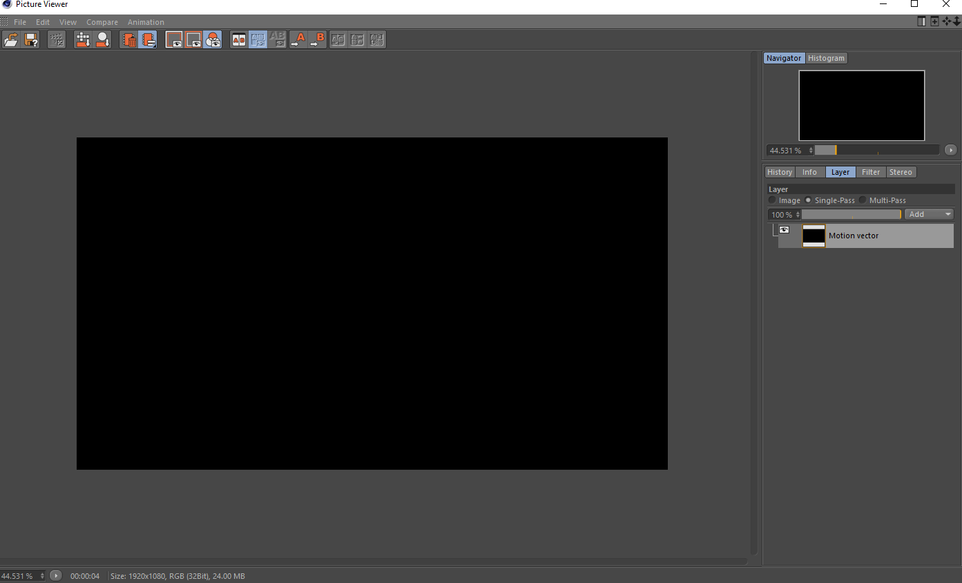

When I enable passes I just get a black screen in my multi-pass:

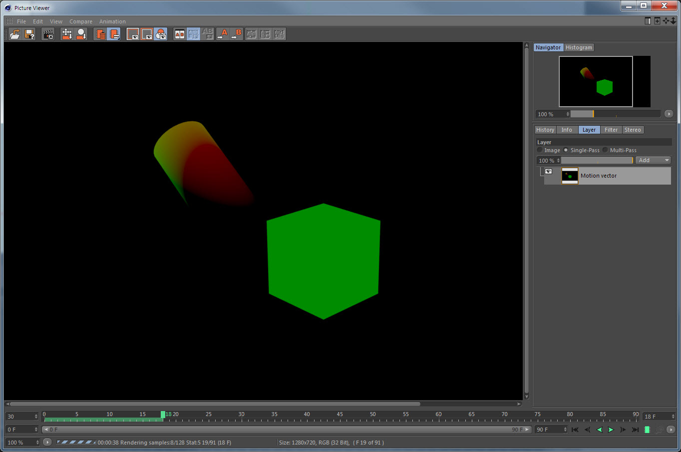

This is a working sample.
Created a new scene. Added some motion and object tag to objects.
Enabled motion blur in camera.
Activated motion_vector pass.
That's all.
