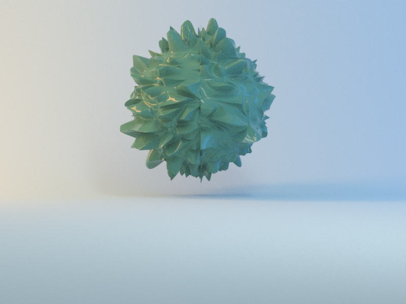

Line going through my sphere when using displacement map
AJM0123
Posts: 22
Joined: Mon Feb 01, 2016 10:16 pm
Sure this is a very fix, firstly if I am posting in wrong section please let me know.
I've attached a quick pic just to show everyone what my issue, if its something very simple I give you permission to take this mickey :lol:
Is it to do with the displacement map? Lighting or something in my render settings?
Many thanks,
Andrew
Posts: 10526
Hi AJM0123,
always better to post question in the c4d section, anyway, it's about uvs and not tiled texture.
If you are using a procedural node with auto baking option active, this an expected limitation.
Octane displacement prefers correct unwrapped not overlapping uvs.
ciao beppe
