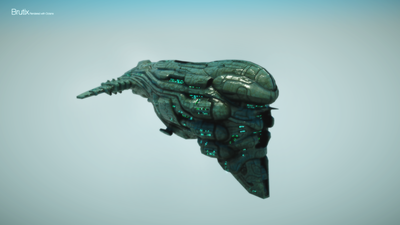

I think I need to redo the Brutix though (was the first one I did) as the diffuse map was a bit off.
