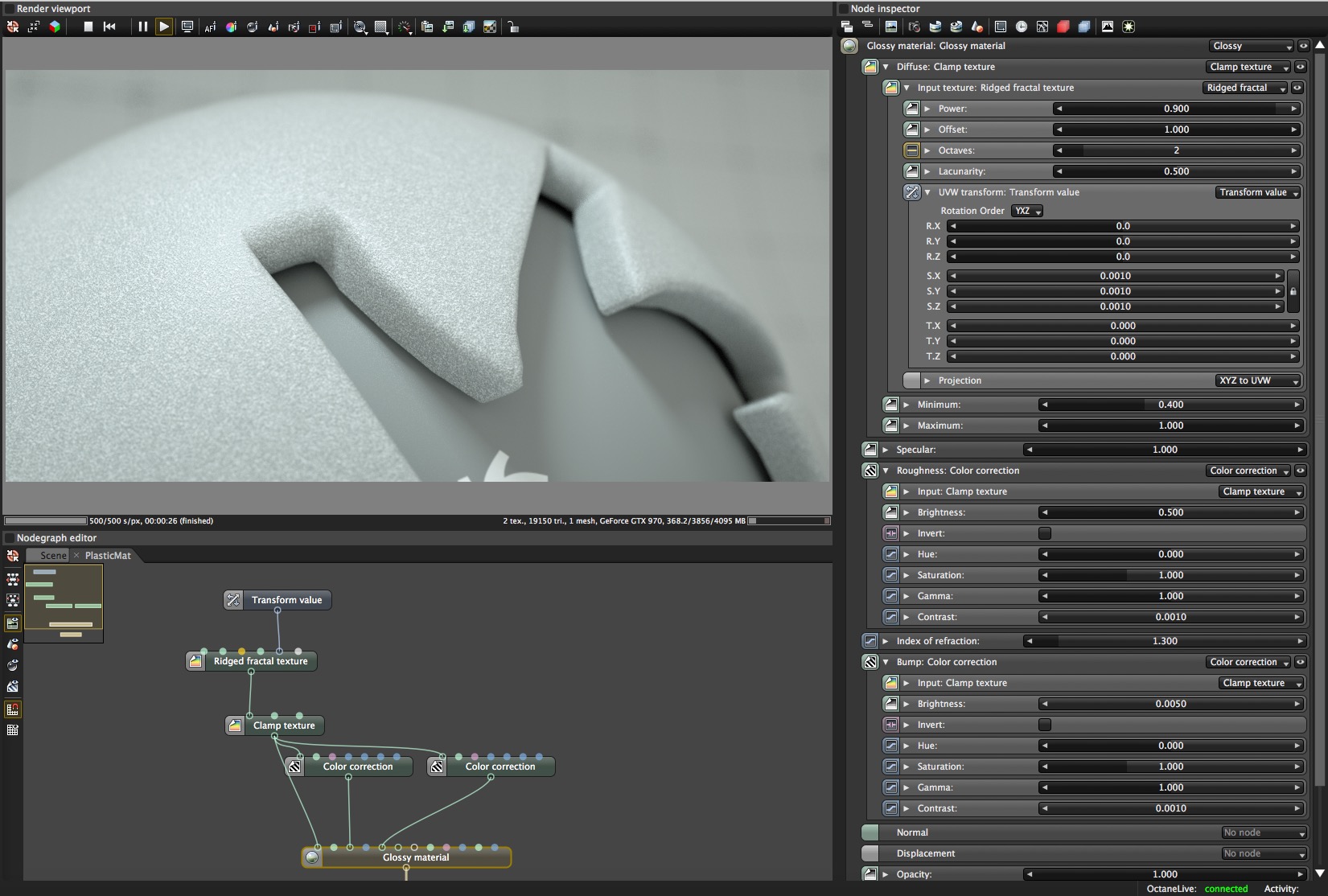

a first attempt of plastic to play with:
without bump
and with bump
You have to correct the scale base on your object and adjust here and there some values:
PlasticMat.orbx
(4.68 KiB) Downloaded 385 times
ciao beppe

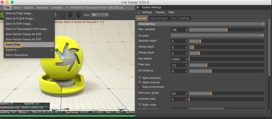

Wow it looks very cool. Thank you very much for the help. Is it possible that I open this material in Cinema 4D with Octane Plugin?

Is it possible to make the Material a little bit darker?
Posts: 10654
Hi jochen,
just add another color correction node between the clamp node and the diffuse pin and reduce its power as needed.
ciao beppe
