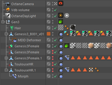

When rendering to the LV everything works perfectly, but when rendering through the PV or render Queue some frame have the MDD deformer and the Alembic files misaligned?
The ABC is an export from DAZ, and the MDD deformer from Marvelous Designer 5

When I render 200 frames in the picture viewer maybe only 2-3 frames will be slightly misaligned. The rest will render fine. If I go to the frame that had issues and look in the live viewer they work perfectly.
I've added an octane object tag to the object group is that not sufficient?
