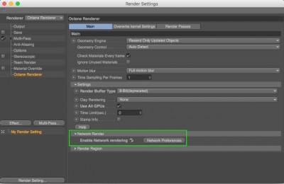

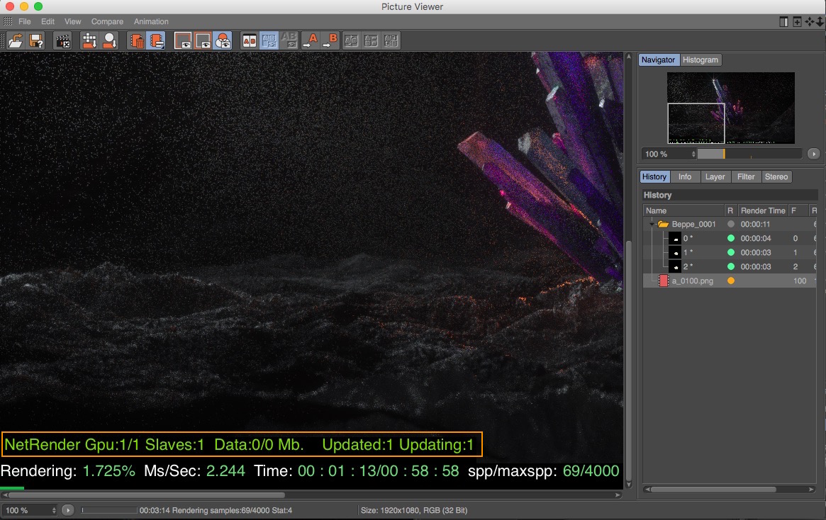

Also one other question with Network Rendering, does it work with Picture Viewer, or the Render queue? Is there any way to verify that it is being used for either one? Thanks!
Posts: 10578
Hi rescue1studios
in Render settings Octane render / Main tb, you can find the network rendering settings for Picture Viewer and it works also for Render Queue:

In Picture Viewer you can see a second info line text about net rendering status in the lower left corner:
