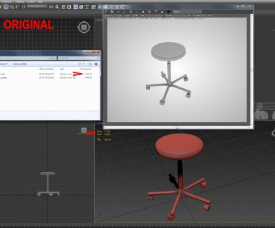

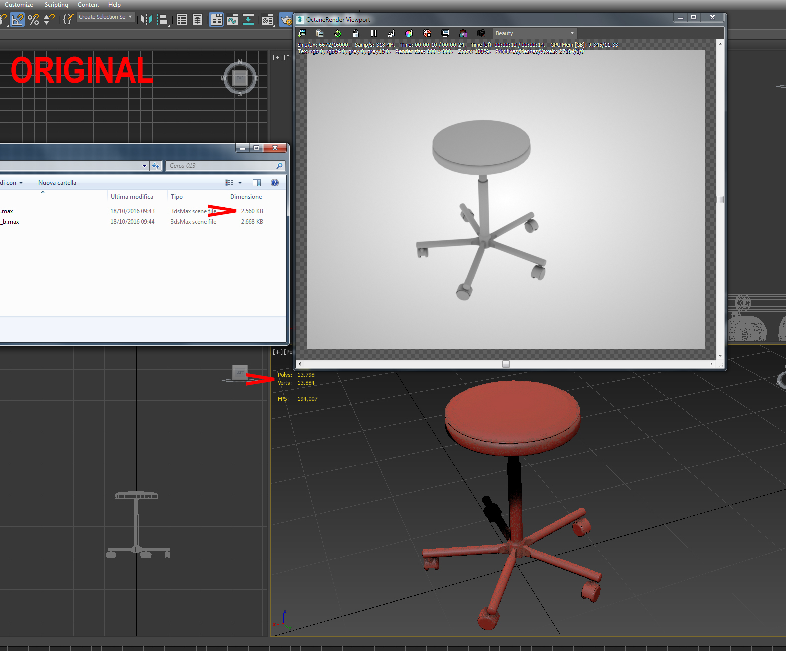

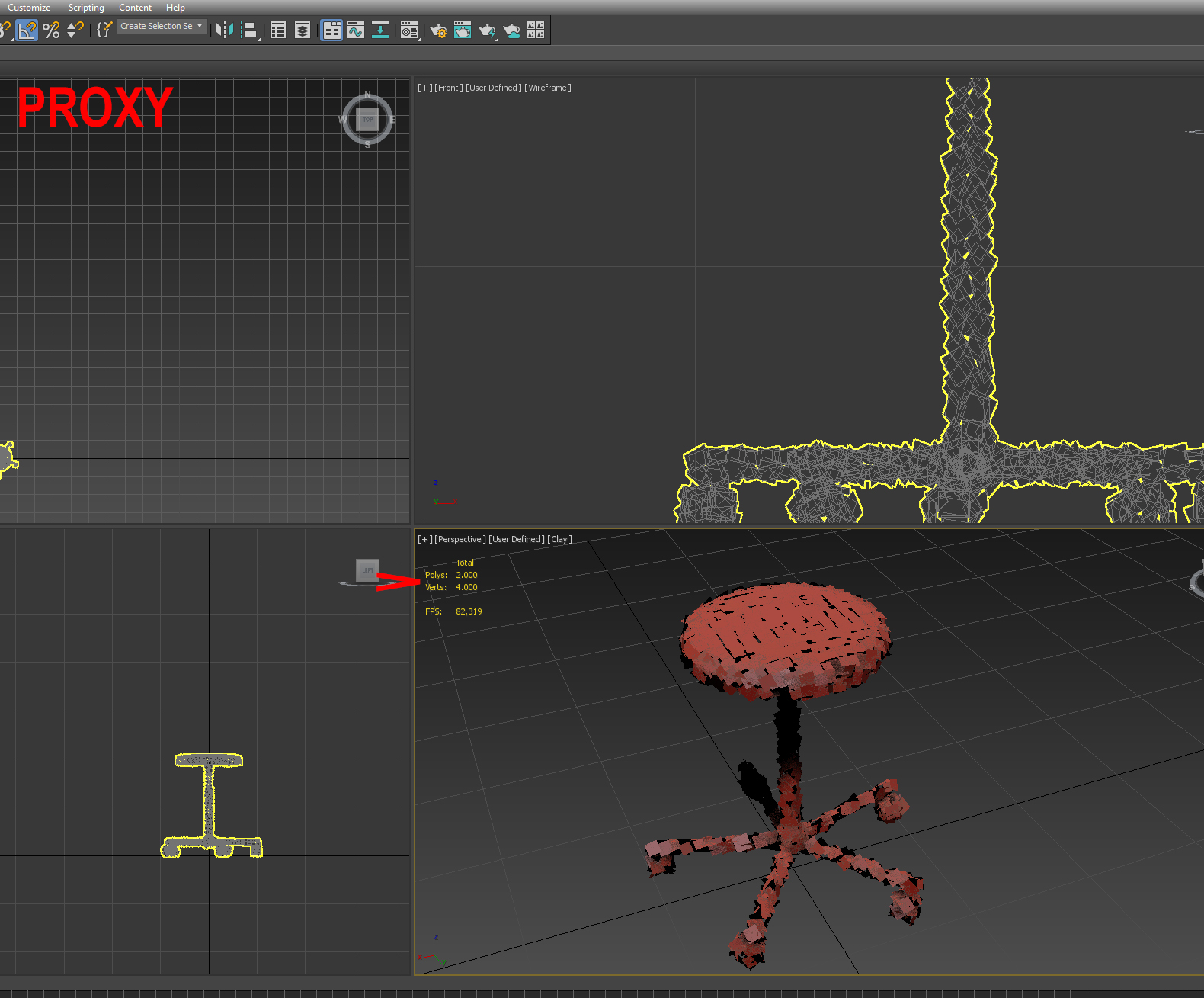

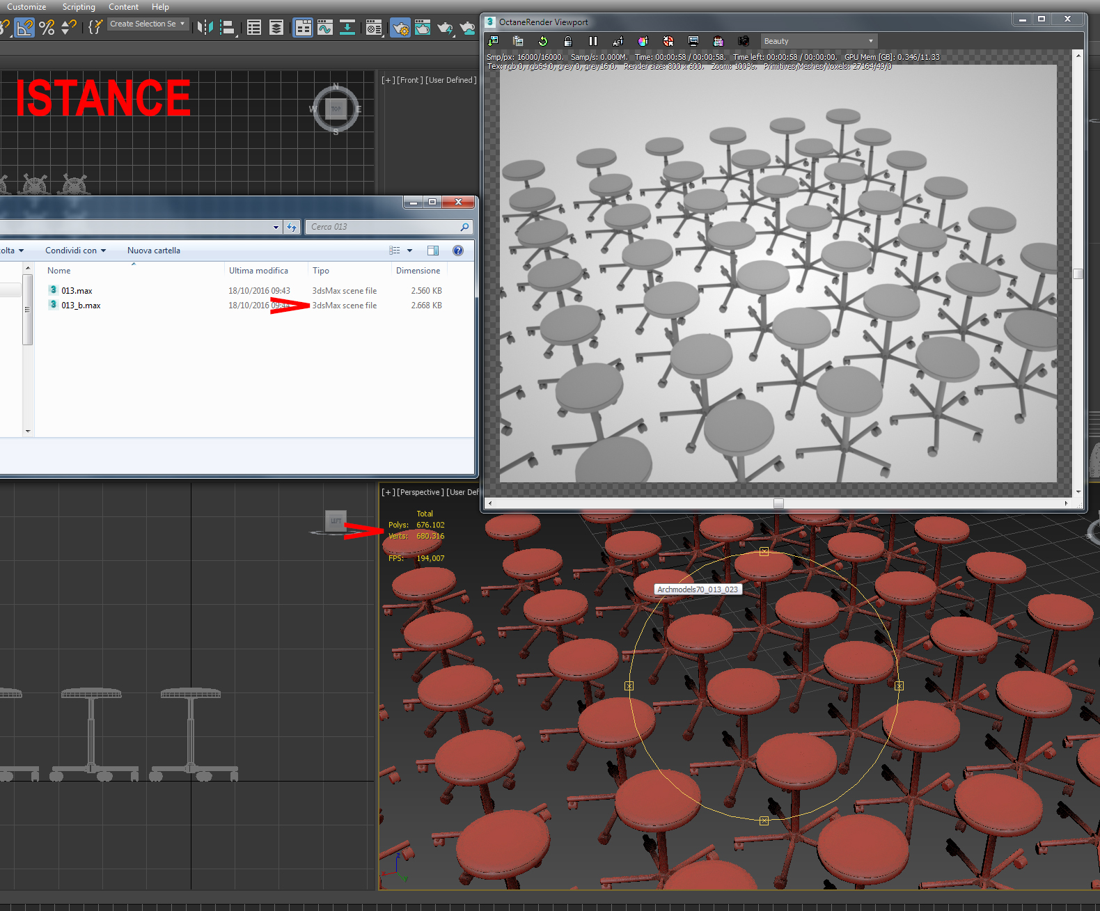

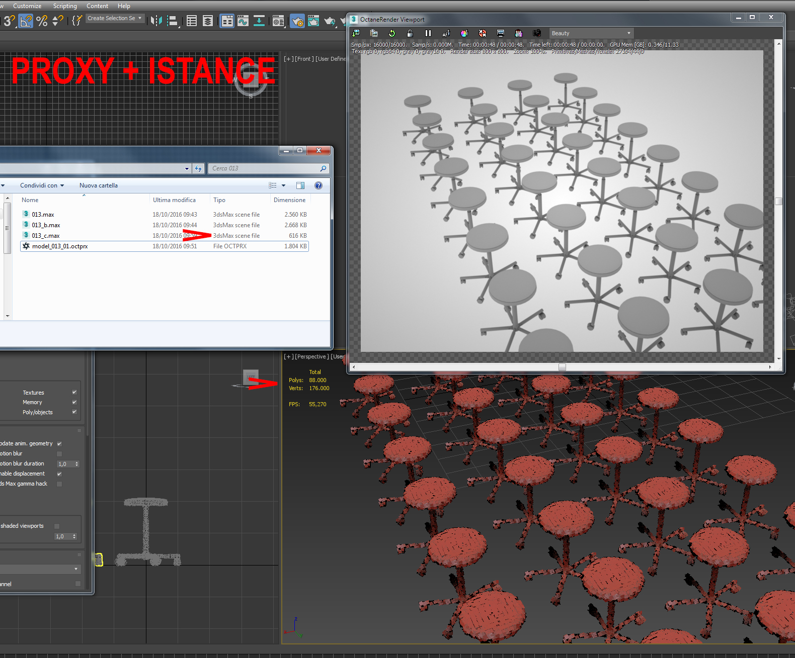

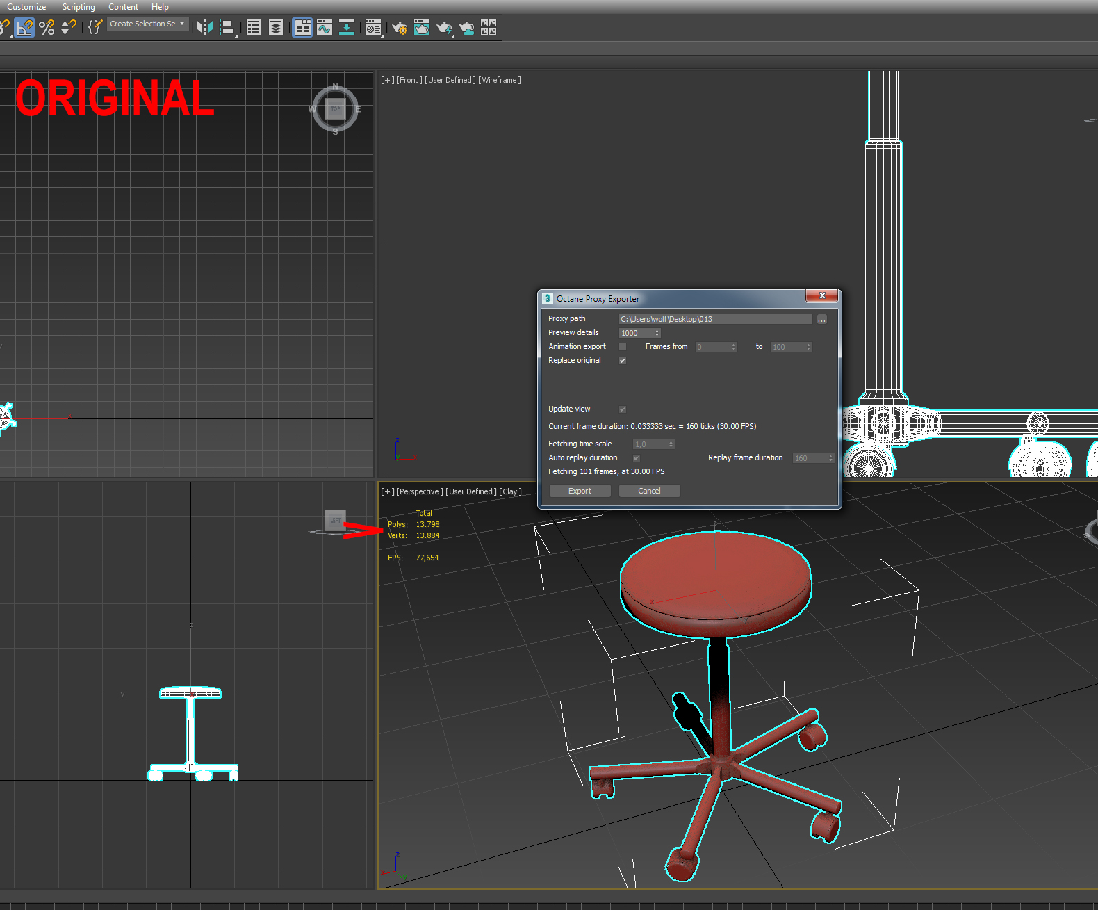

Hi Tharso,
the instance command and proxy make small files saved and reduce the polygons in the scene.
As you can see in the screenshots the proxy significantly reduces the amount of polygons and istance do not increase the file size.
your issue may be related to other factors.
