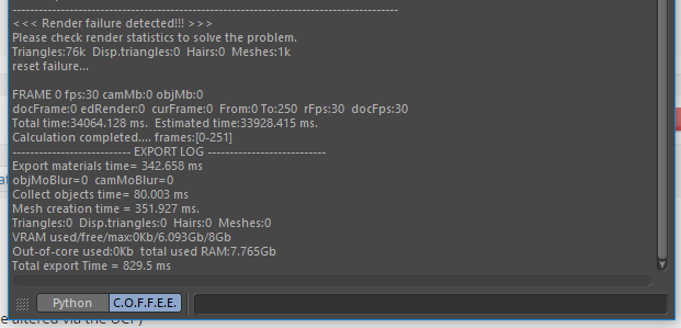

Running into some stereo render issues....
Info:
Octane 3.03.4
Octane 3.03.3 R1 for C4D installed on R13
GTX1080 / 6900k / 64GB Ram / etc etc
When I render the scene in cube map, spherical, all is fine, including ALL stereo output options (except over/under) and the scene takes approx 360MB.
When I select over/under I get a pretty instant render failure whenever I try to output any size, tried 1000x500 and 3000x1500 and neither worked (slowly working my way up).
Ideas?
*edit* Crash report included.

Updated to the version you posted, now spherical is crashing as well. Is there a version that is known to actually... work?
This is live in production because I need VR stereo. A build that is KNOWN stable would be appreciated.
Crash report attached.

I tried your scene and it renders fine on a 1080 in the plugin of version 3.03.4-R3. When switch to the camera object "Camera 1" it still works fine. When I enable "over/under" stereo it fails when "swap eyes" is enabled, which is the bug Arturo was talking about initially and which is fixed in 3.04. Disabling this option makes it work correctly.
