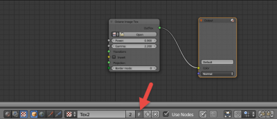

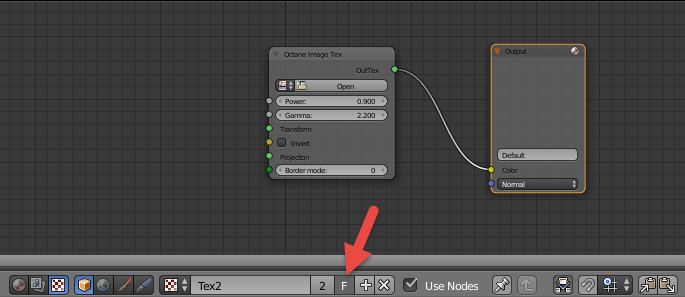

OK, I see the problem... You need to enable the "Save this data-block even if it has no users" switch in Blender's texture UI for any textures referenced by Octane environments:

Thanks JimStar, works as expected now. Never knew what that button was for.

Using this function allows unused materials, environments etc. to be saved in the blender project. If it has no uses (it is marked with 0) and will be deleted on next file opening.
