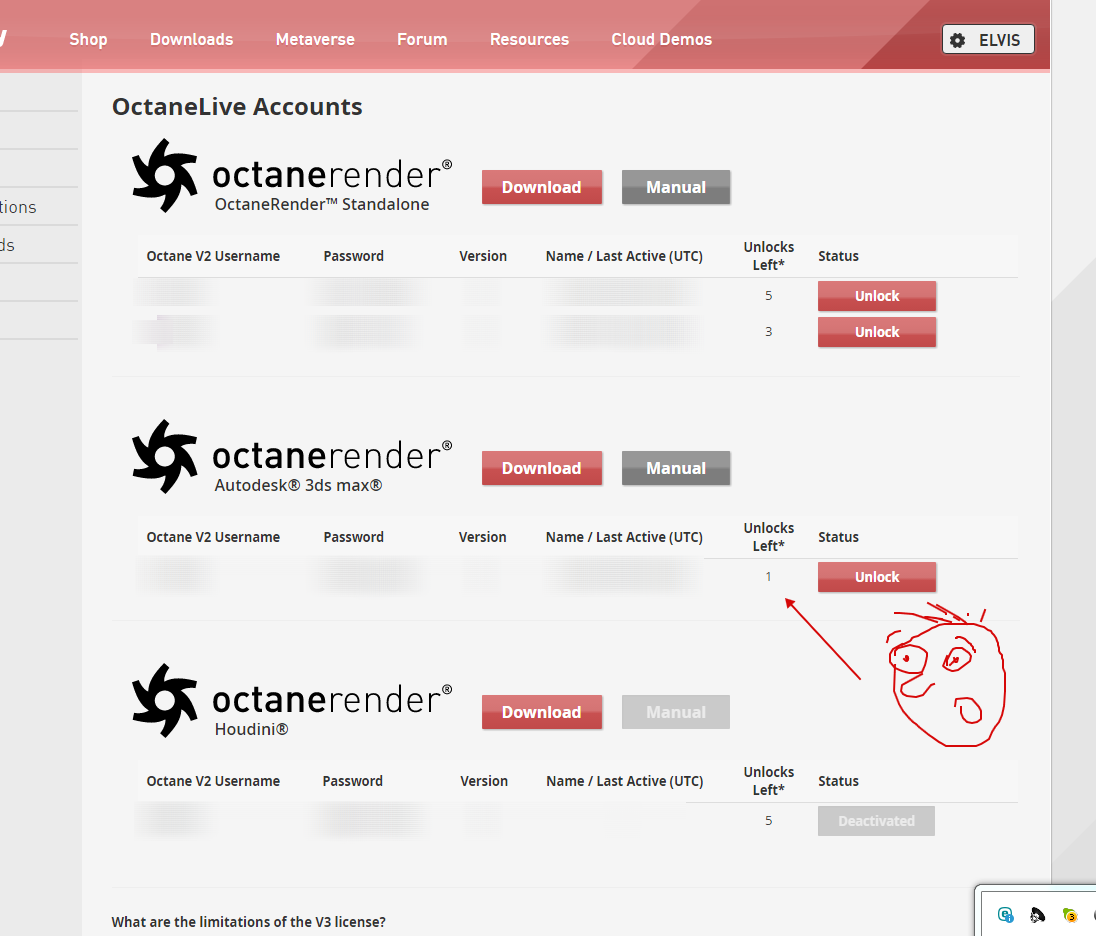

wrote in support, gave only one unlock , this is a joke?
I often deactivated, working in the office and other systems
why they have come up at all?
unlock only one gave

in my office system is not very stable during the second month, I try to find the problem, constantly having to deactivatemojave wrote:Hi Elvis,
Can you please explain why are you using the unlock functionality? Licenses are automatically released so you should not have to do this unless there's a problem.
Thank you.

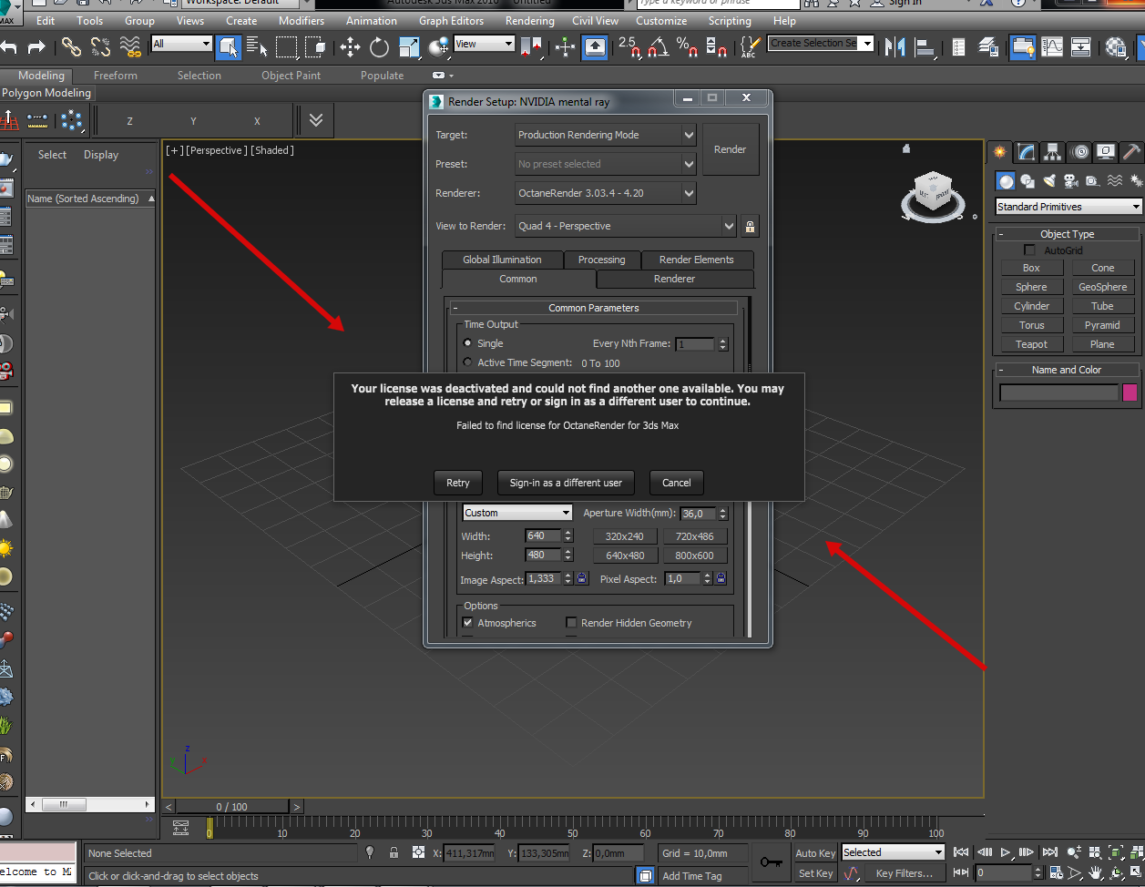

If my system is out with an error 0x000000f - 0x000000e I can not activate on another computer octanemojave wrote:Hi Elvis,
Can you please explain exactly why you need to deactivate manually via the web and if there's any way in which we can help you so you don't have to do so?

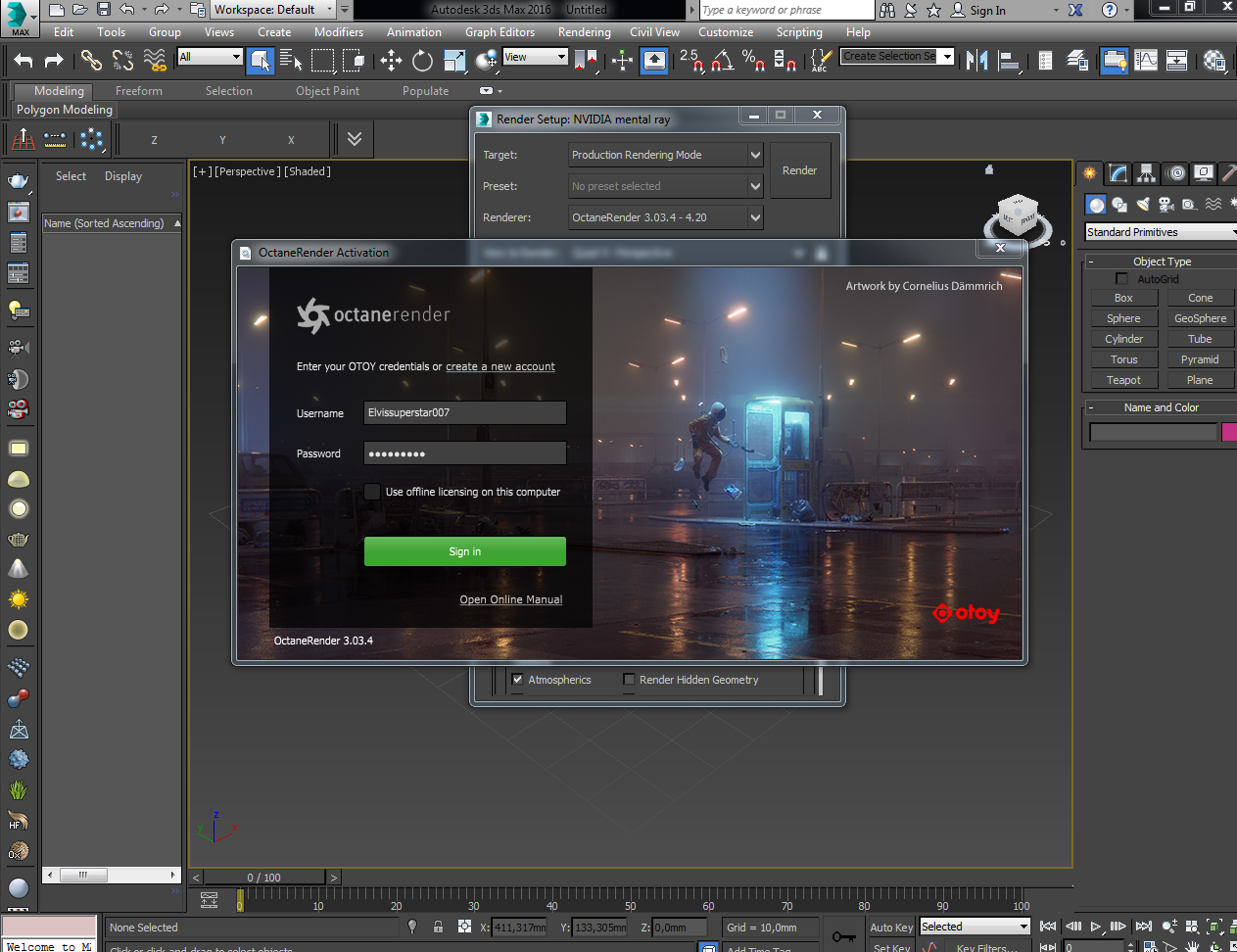

Can you please explain what do you mean by error "0x000000f - 0x000000e"?
If your machines are unstable and likely to leave your licenses locked I'd recommend to not to use offline licensing or else unlocking via the website will be your only way to release the license. Otherwise licenses should be released when the the host application (Max in your case) is closed.
For what I see from your error, your session has expired, you need to re-sign in and then sign out via the plugin's account settings, for what you'll need a valid Internet connection.
