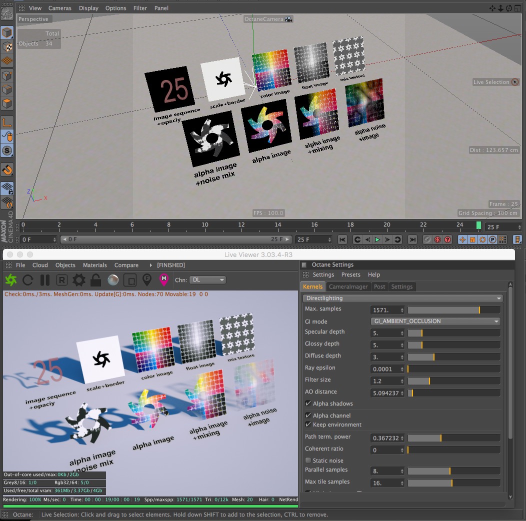

Hi justinanixon,
please, look at this scene prepared by aoktar about imagetexture and alpha in Octane:
ImageTextureExamples.zip
(693.38 KiB) Downloaded 520 times
You can download all the example scene files in any c4dOctane release post, here is the direct link:
https://render.otoy.com/plugindownloads ... scenes.rar
