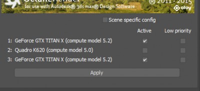

Hi mark0spasic,
What about low-priority in device tab?
Paride
