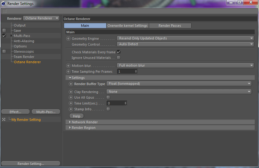

otherwise what should i revert back to default from the following image:
Posts: 16068
Location: Türkiye
second pic. It looks as default.
My though that LV has all movable at default. And "auto detect" cannot detect your displaced geo. It should be movable to get same results. What's your version?
Try add an object tag to displaced geo or use "all movable".

Setting geometry control to All Objects Movable and adding Object tags on the displaced objects worked.
Thanks dude!
