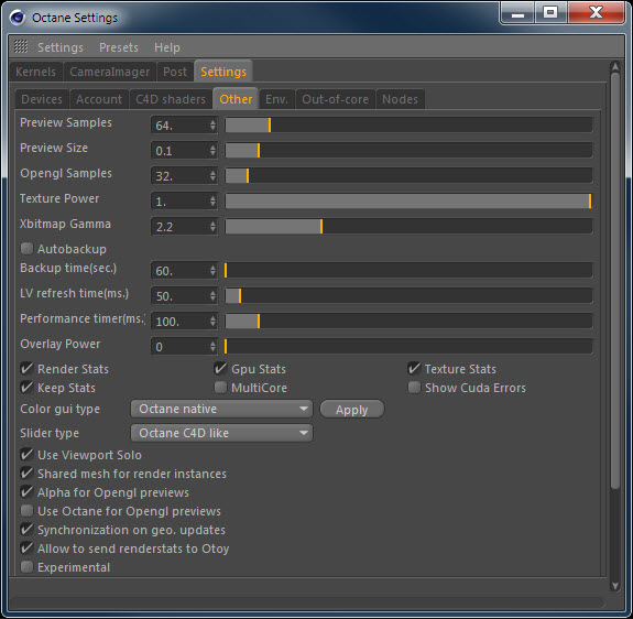

Are you on OSX? What's this parameter on you?
- Attachments
- a1.jpg (22.14 KiB) Viewed 4439 times

That did it! Much thanks! No bug after all.

May I ask what the rest of your Settings/Other look like?
