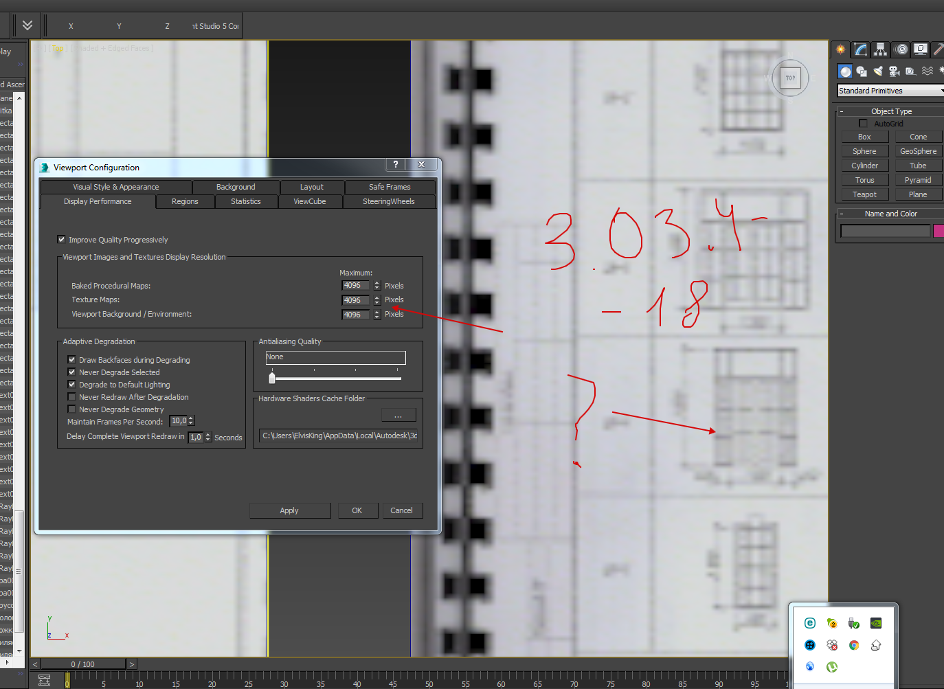

Texture resolution is not working 3.03.4.-18

Hi Elvissuperstar007,
I would not think an Octane bug.
Have you tried the same test using the scanline render?
The issue you refer persists.
Regards
Paride
Regards
Paride
Do that in Render settings ..Elvissuperstar007 wrote:Texture resolution is not working
Mat. preview W/H set it like 2000x2000
turn off display textures on viewport than turn it on again..
that should then work..
it was a silly workaround from the start up.
I already asked Neon to correct that mistake. Hope this will be heard
