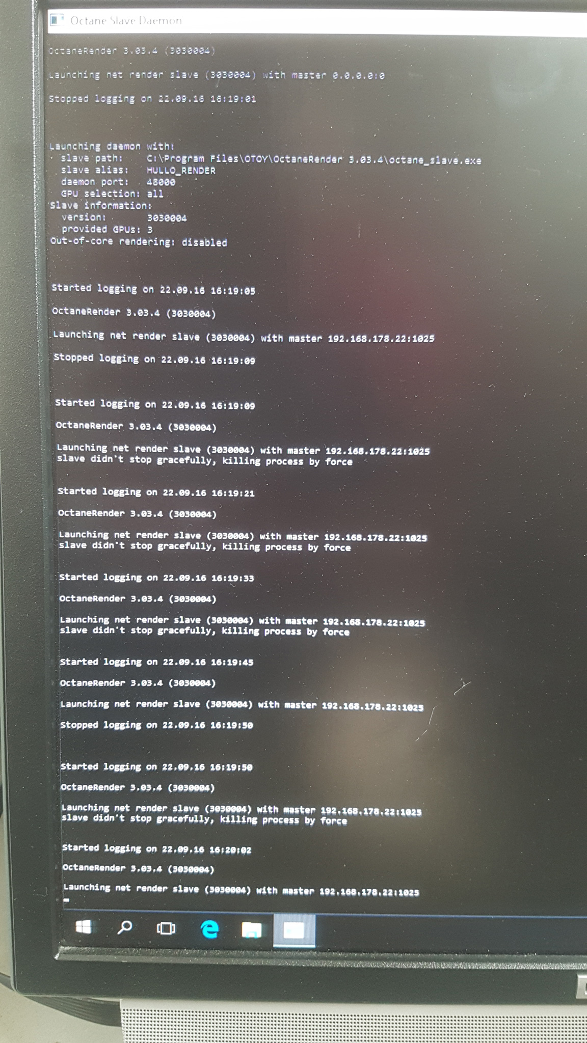

Just installed and tested the BlenderOctane v3. I'm having some network rendering issues and resulting in starting and stopping of the slave deamon over and over again. I keep getting these "didn't stop gracefully" errors when rendering in BlenderOctane itself ( see attachment ). I've exported the scene to ORBX and tried it in Standalone v3 and this works fine with network rendering ( after restarting the deamon ).

Image of Slave Deamon

Image of Octane Slave Deamon

I'm not sure what is going on and I don't have any insight what the Blender plugin / OctaneServer does, but by the looks of it, it seems that the Blender plugin is constantly trying to bind/unbind the slave. How do you enable/configure network rendering in the Blender plugin? I assume you don't use net render configuration dialog like in the Standalone, do you?

Thank you very much. It is as I have expected: The master (i.e. the Blender plugin) is constantly asking the daemon to start and stop the slave. Dmitry will have a look at it next week, when he's back from vacation.
