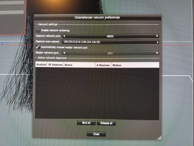

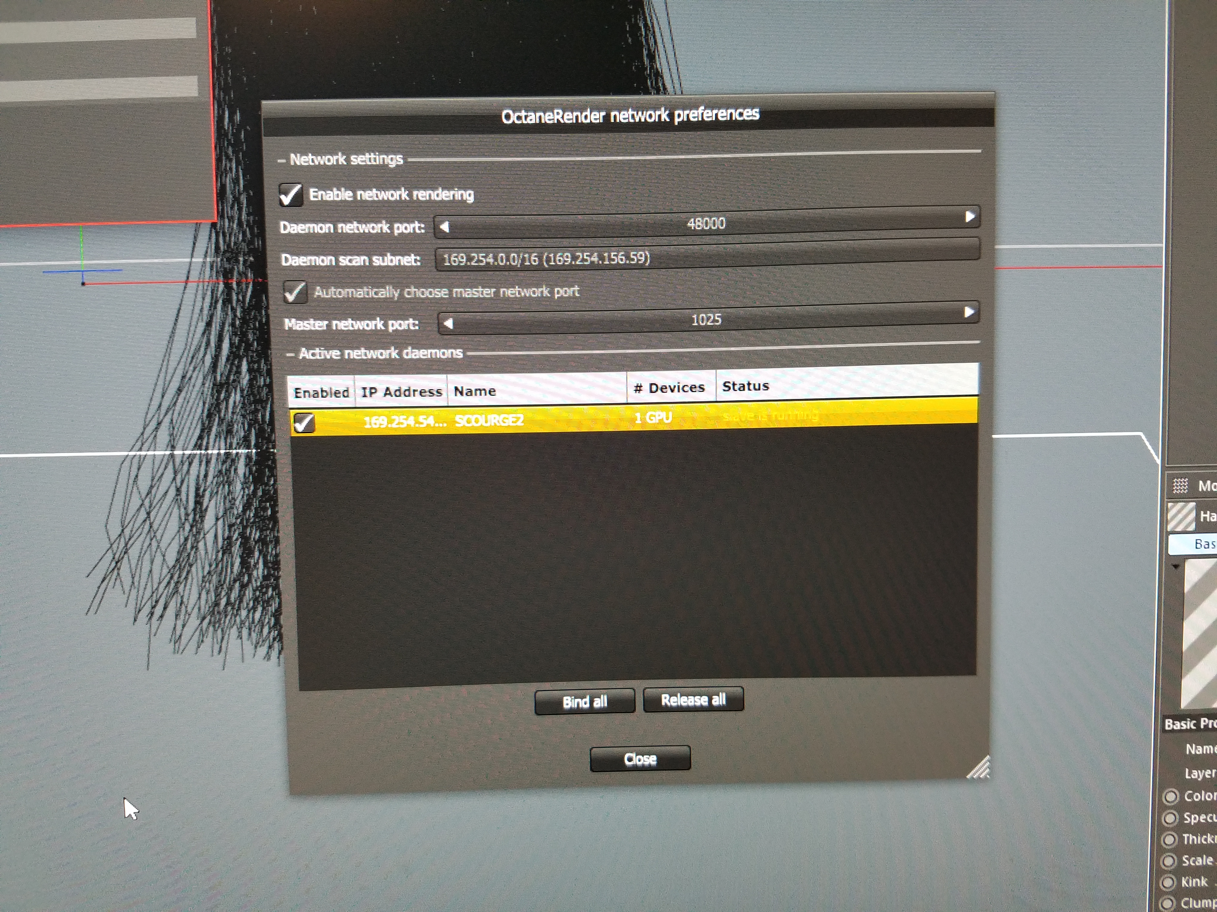

I know because when I switch back over my renders are taking longer...so then I open the network render preferences to check and find out that they are not active anymore.
See Pics (sorry for the sharpness and lines)

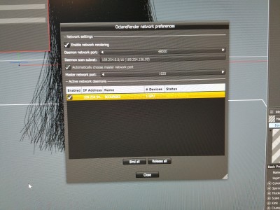

I turn on Network Render

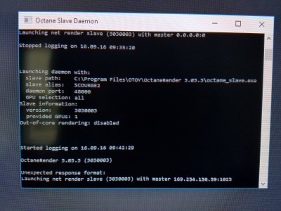

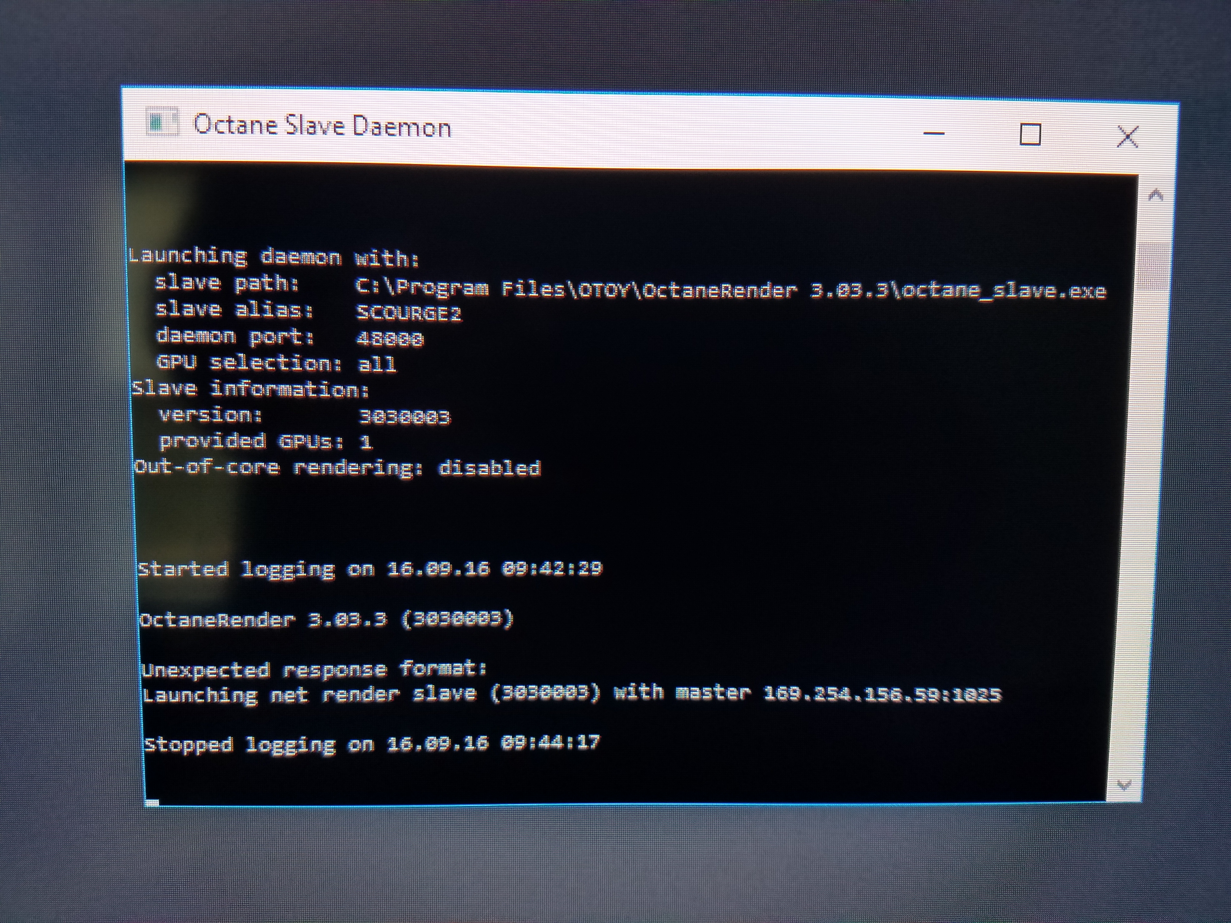

So then my slave looks like this.
After a bit I notice my renders slower. I look into network rendering and this is what it looks like.

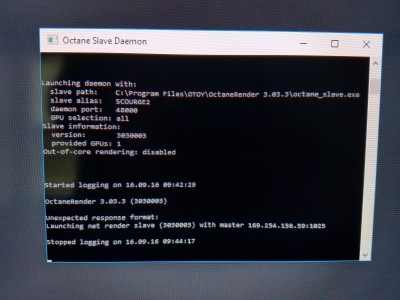

And this is what my slave window is saying.

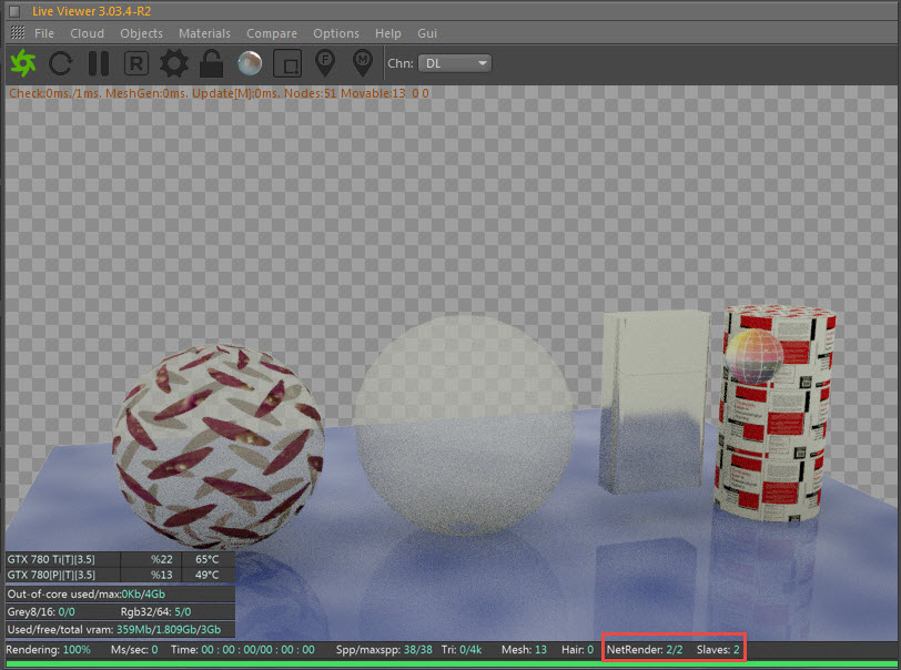

You can check slaves from LV info or PV info lines too.
Here is see a message: "unexpected response format". Don't know what's that but maybe reason to lost connection.

These are

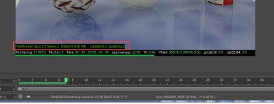

Got it thanks. Even when network render is on I don't get the specs about the GPU in the other computer on my screen like you do. Also, when net work render is on I DO get the Slave 1/1 visual....but that goes away when the network render loses connection. obviously.
