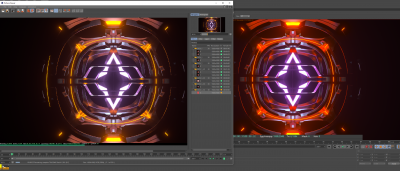

attached C4D file and a picture of how it looks in my computer.
Please help! LV different COLORS than PV. Im on a deadline!!

You're using Float(linear) output. LV displays result with camera response. That's not linear output. Linear means RAW output without applying any color correction to results.
