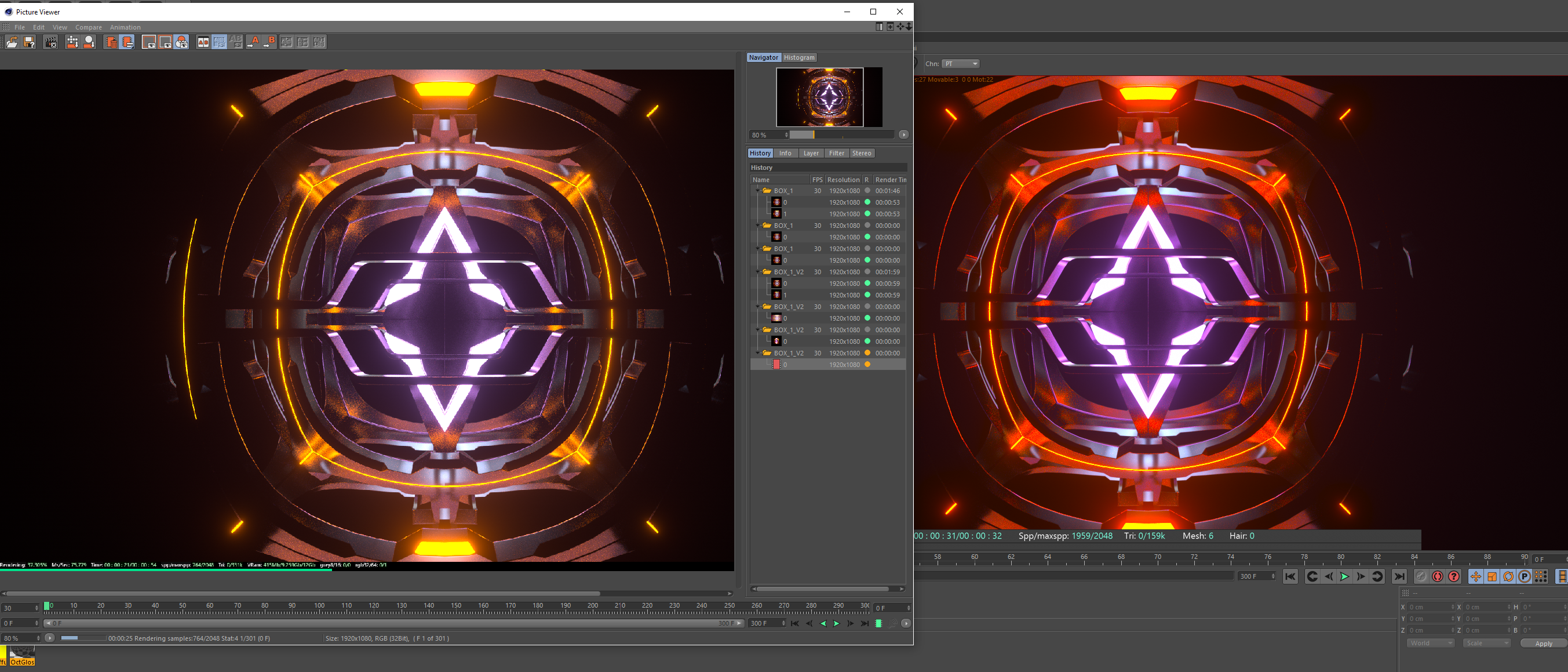

Please help! LV different COLORS than PV. Im on a deadline!!
Roboto
Posts: 34
Joined: Mon Nov 09, 2015 8:21 pm
Look through the forum for a solution, found similar problems but none of those solutions works for me.
It randomly started happening 2 days ago, till now I always used the same configuration for my renders and never had this problem.
installed the latest version of Octane just now to see if that fixed the problem. No luck!
I found that sometimes I can paste the whole scene in a fresh new file and colors are ok. But has the same settings of the original comp.
Does anyone have the same problem?
please help, I am in the middle of 2 projects and need to figure this out.
attached C4D file and a picture of how it looks in my computer.

You're using Float(linear) output. LV displays result with camera response. That's not linear output. Linear means RAW output without applying any color correction to results.

Thanks aoktar, I now feel like an idiot
