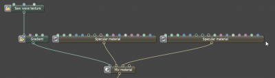

Set up two specular materials, one rough one smooth, put them in a mix material and use a gradient in the texture slot to mix between the two.

I would try a mix material setup, works wonders, and you can adjust the slope accordingly real time

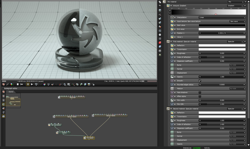

I get that result however, no gradient effect...
What did I do wrong ?
Win 10 / XMG Core 14 / dGPU GTX 1650 + eGPU RTX 2070 Super / Octane for Sketchup
Posts: 10360
Hi aquelito,
what happen if you rotate the camera around the material-ball object?
Do you see the gradient?
ciao beppe

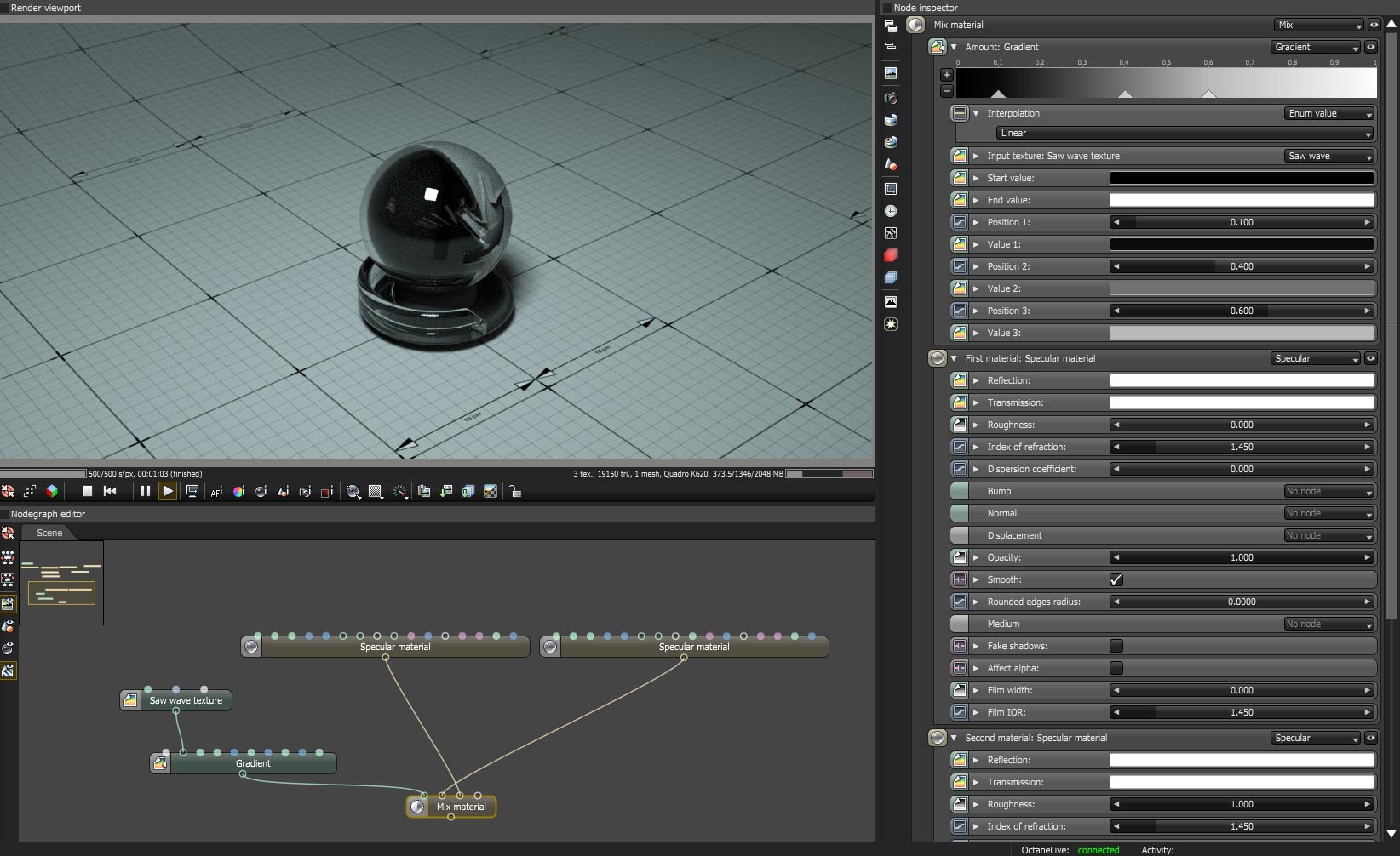

Hi Bepe
This is what I get : apparently no gradient is showing up :(
Posts: 10360
check the Saw wave node projection, probably the issue is there :roll:
ciao beppe
