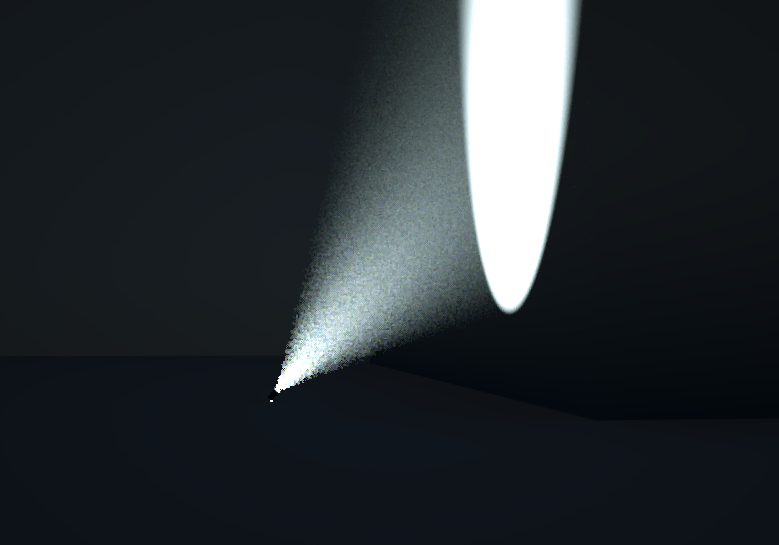

Great, thanks Paul,
That's working, I am getting quite a bit of noise, even over 4000 samples, but will play with the settings some more.
face_off
Posts: 15809
Location: Adelaide, Australia
I think that is the particles (medium) rendering rather than noise.
Paul
