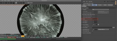

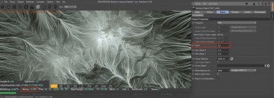

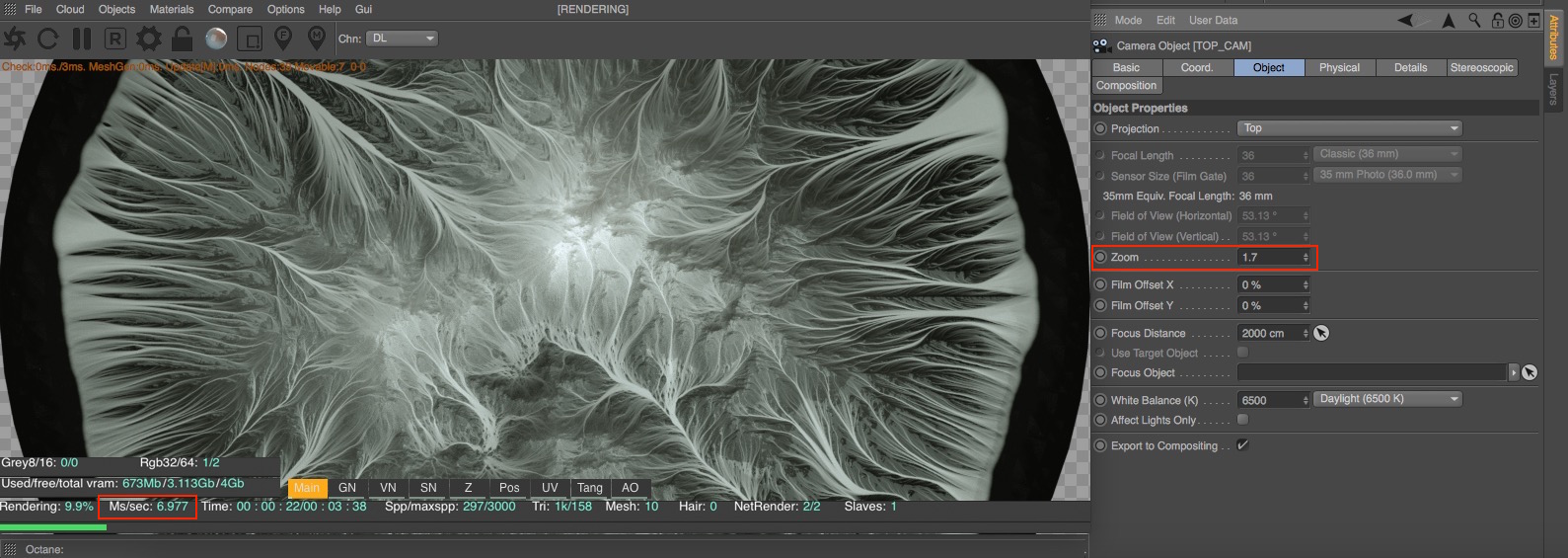

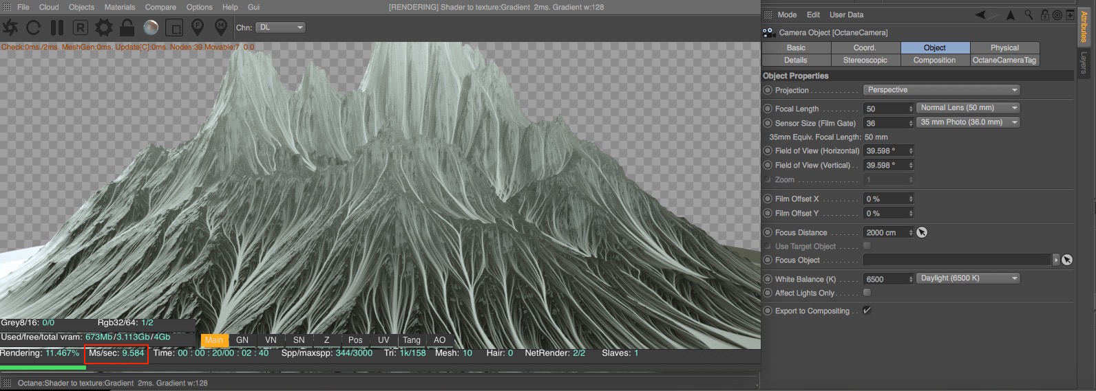

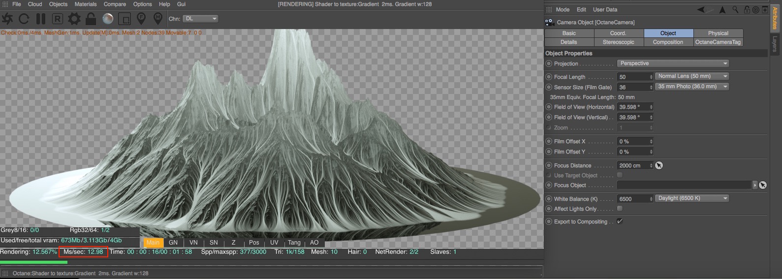

maybe I'm wrong, but I think that there is no issue in your scene.
If you change the zoom factor in the Orthographic camera, you'll see that the render time changes accordingly:

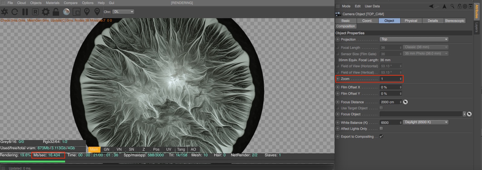

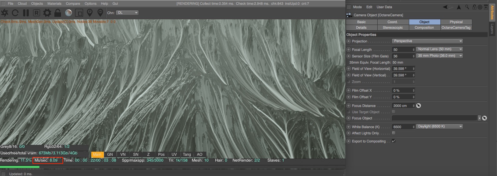

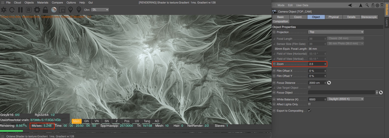

but you have the same effect if you zoom in with a normal camera. Since the object is covering all the buffer, the render time is higher... isn't it?
