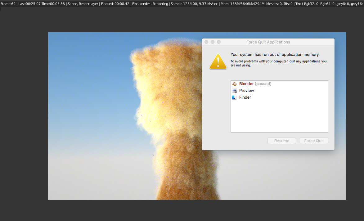

Even with animation mode set to "Movable proxies" and all objects to "Reshapable" I still got the out of memory error - this time after only 70 frames.
