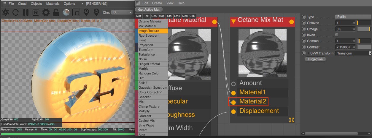

I'm running r17 and 3.00-r1.1 and it seems bump mapping just flat out doesn't work with displacement, even with the work around of use displacement in the mix material. I've attached a scene file.

you forget to connect the material in both the materials pins of th Mix material: anyway it cannot work well since the bump has a diiferent uv transformation.
My suggestion is to bake the bump and add it to displacement in PS or Bodypaint for best results.

Ok that's really really inefficient, so every time I want to change procedural bump I have to rebake it??? - is this an issue that's going to be resolved? I swear this worked in V2?
Edit - removing UV transformation on bump map made no difference to artifacting...

unfortunately displacement has not changed from v2 to v3 (excepted for the Shift/Mid-level value) and we are aware that there are a lot of limitations right now.
The displacement should be revisited later on, after 3.1 is out.
