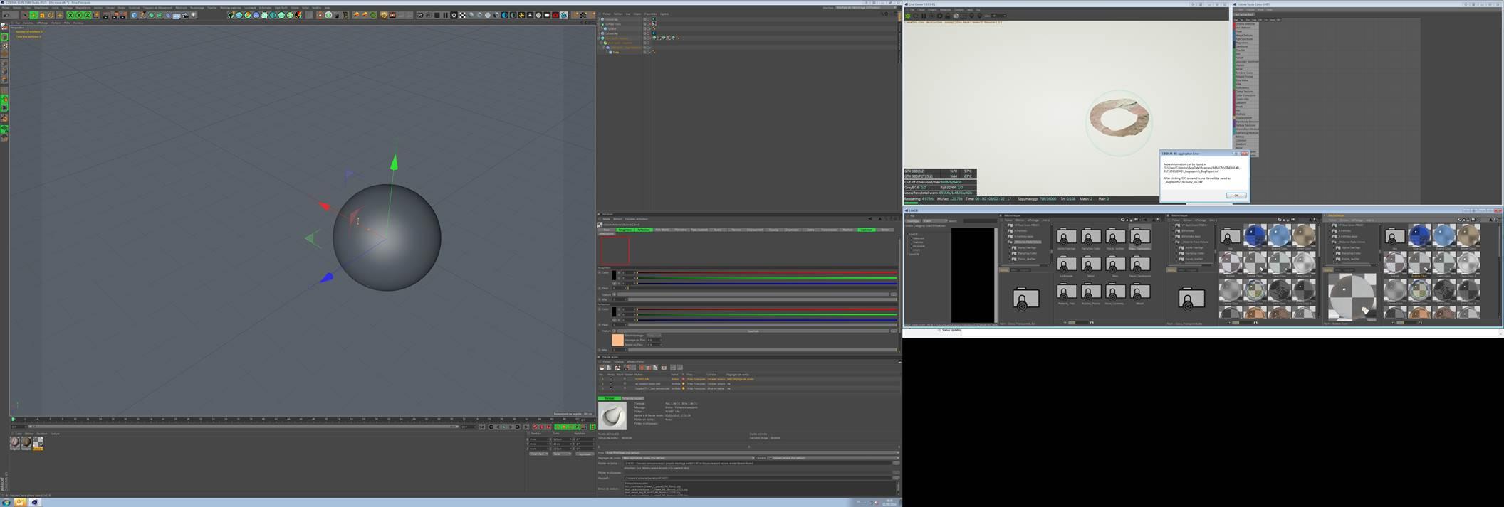

Hi guys,
I tetsed the pixel lab material pack and some materials specificaly made for octane cuses a C4D error.
the crash seems to come from the octane plugin.
Do you experienced this kind of problem in the past ?
thanks

here's my bugreport file enclosed.
thanks to have a look please.

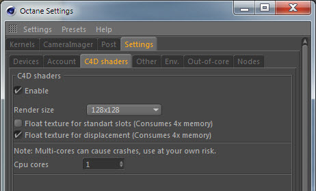

Posts: 16068
Location: Türkiye
Have you read my message? There is a "SLA" crash which comes from C4D sdk about rendering a C4D Layer. It happens when you have multi-core>1.

Posts: 16068
Location: Türkiye
Bertritude, This is that. C4D shaders are not evaluated as Octane shaders on render-time. They are pre-rendered before render begins and mapped as image_textures. If this guys done a material setup with C4D shaders that's not good way. Lot of performance loose. Best to use Octane nodes.
