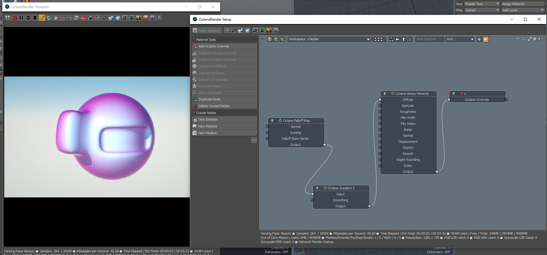

Is it possible to obtain a similar effect like the modo gradient set to incidence angle with the Octane materials? Then you have this:

oh it works
thanks a lot calus
