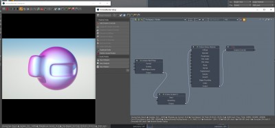

Hi all,
Is it possible to obtain a similar effect like the modo gradient set to incidence angle with the Octane materials? Then you have this:
http://modo.docs.thefoundry.co.uk/modo/ ... e_Grad.jpg
Thanks!
M.

Yes,
you have to plug a Falloff map node in the texture input of an Octane Gradient node.

oh it works :) thanks a lot calus :))
