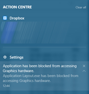

check this Error from earlier today. That's what windows app center gave me as message after 5-6 sec freeze while Octane was rendering and then aborting render. After that i had to close layout, photoshop and DWG viewer, they all "lost" openGL/image in programs.
- Attachments
- Octane_Crash_GPU.jpg (86.99 KiB) Viewed 8500 times
