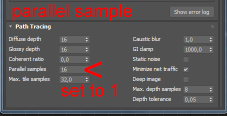

- In the 3dsmax render is more slower than stand alone. but not some second. Minutes. For exemple same scene in 3dsmax almost 3 minutes in 15 second stand alone.
>>>> 660ti video card does not have a lot of ram, You should try to set the parallel sample to 1 and then increase it and check.
