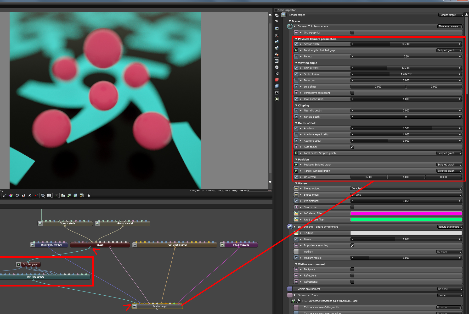

- CAMERA for max NOT EXPORTED
>>>> This is not a bug, it is an alembic issue. I am attaching a lua script by Bepe4d. It's a workaround for using the 3ds max camera in stand alone.
(SCREENSHOT)
