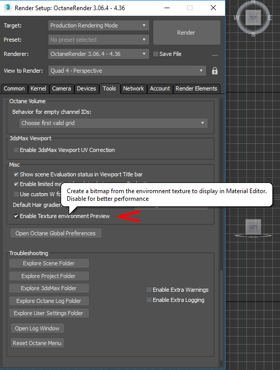

- paride4331
- Posts: 3989
Hi all,
in reference to the post:
viewtopic.php?f=80&t=57079&start=20#p293499
I do not know if this Envrironment slot material issue is related to the plugin version.
Could you tell me your gpu used and nvidia drivers?
Did you change GPU between 4:21 and 4:22?
Regards
Paride
Regards
Paride

OK, here is what i managed to check:
- all images are on local drives
- there are HDRI images also
- problem raises when in Material Browser is open additional library with many materials
- as higher number of materials - the longer time of waiting is needed
But this issue doesn't show up all the times, I'm trying to specify the circumstances when it appears.
