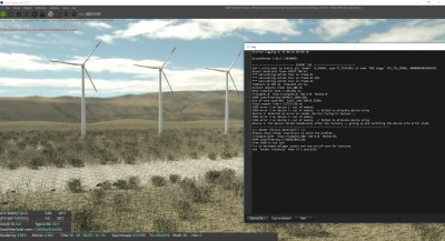

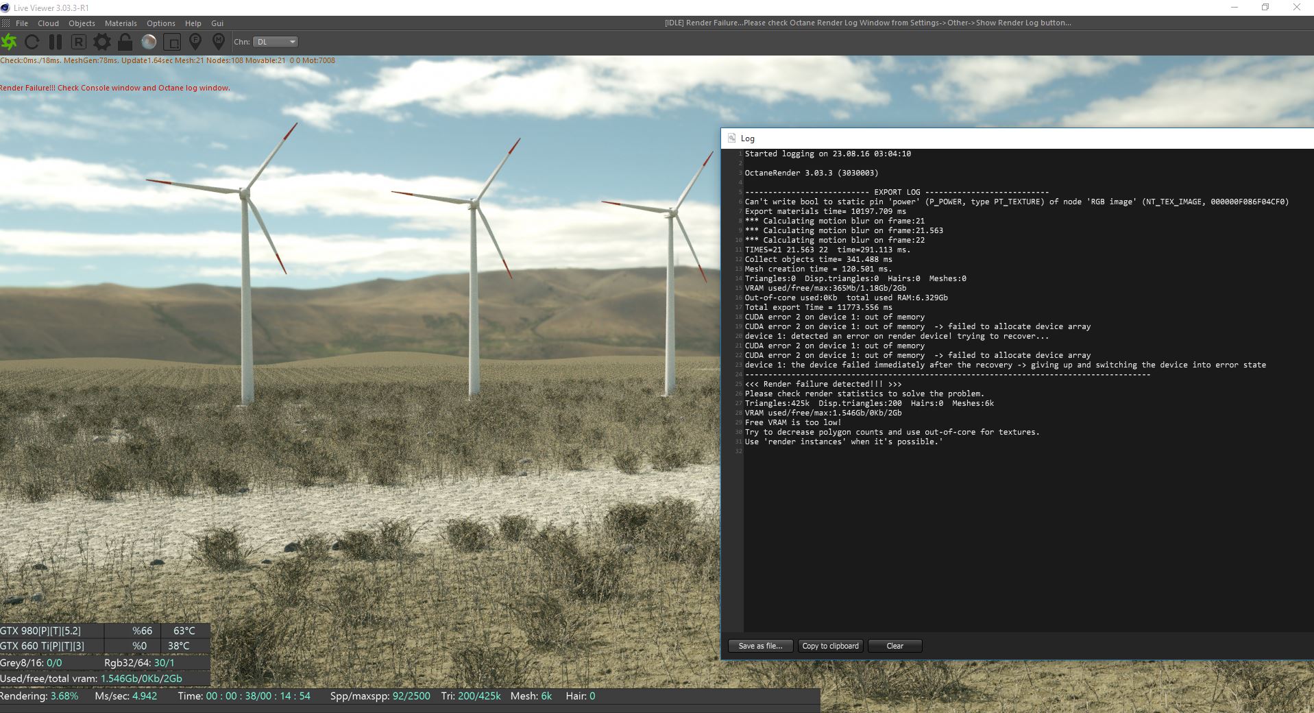

I have a scene with few objects and they are instance objects but I get this error :
I thought that we have unlimited ram on this version and while has object increase polygon to 7 million poly show me this error

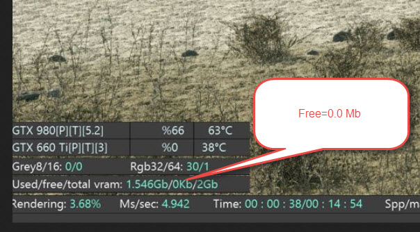

Can you check my image? Making any sense? Polygon should fit to VRAM.

Lot of informations you should know. We have explained many times in topics.
Monitor connected gpu loose lot of ram to OS and host programs. When you activated two gpus, Octane has vram as minimum VRAM.
Go step by step and understand vram usage. Check on a empty scene how much free VRAM do you have for with both GPU and only with 780.
Be sure out-of-core activated. And i'm gonna move the topic to out-of bugreports section.
