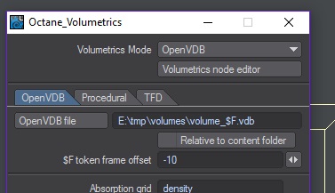

juanjgon
Posts: 8867
Location: Spain
For the next build, I've added a new parameter to set an offset for the current frame that is extracted from the $F token.
Thanks,
-Juanjo
