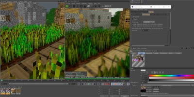

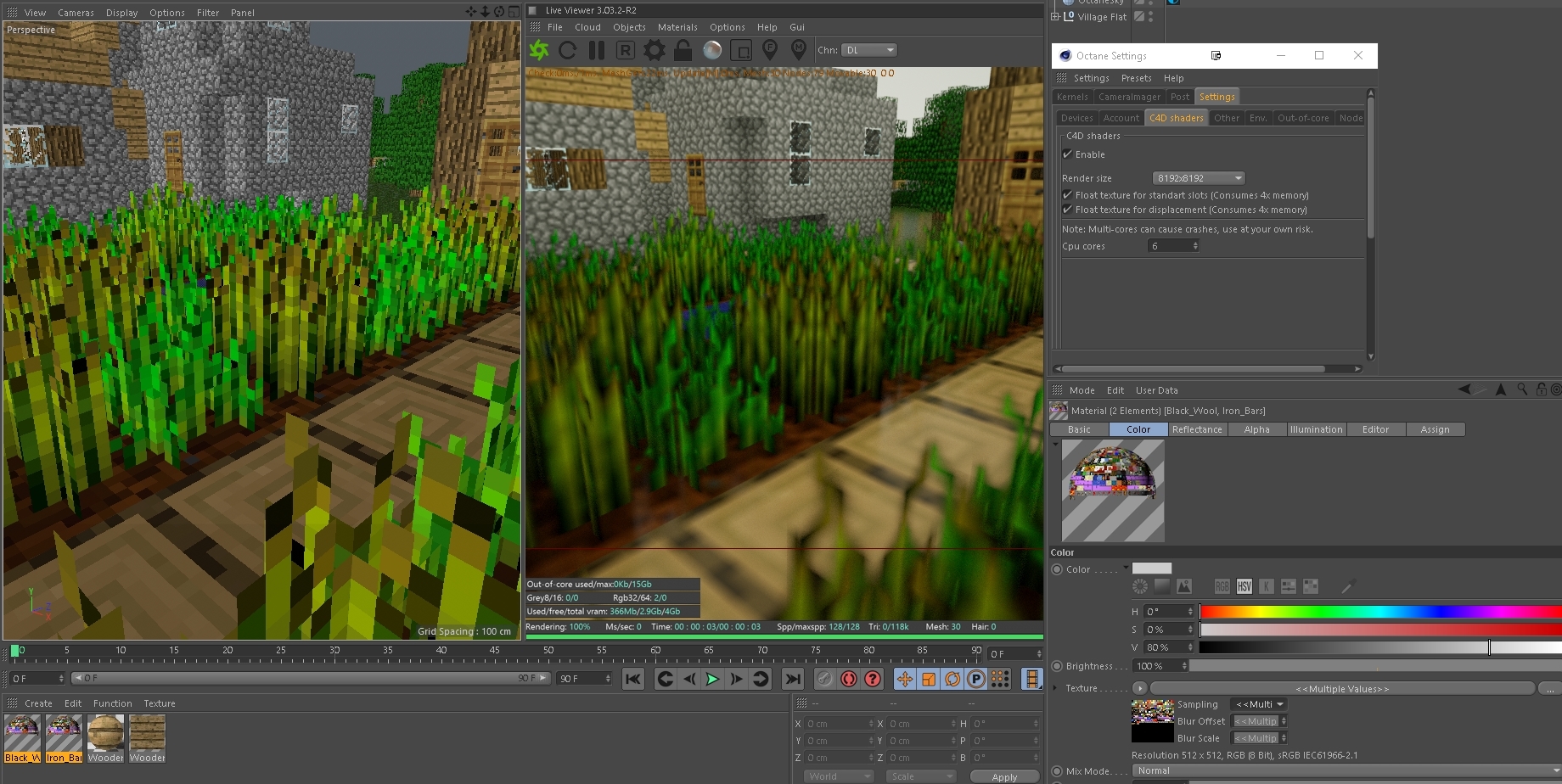

Though Ive noticed MANY of my textures are always smoothed (like C4D Native MIP mapping)
Ive tried making the preview sizes in the textures very high, hoping to see the highest quality, but no matter what Ive tried it always turns out to be smoothed out like MIP mapping?
Is this a bug or is there an option that im missing to have my textures look as sharp as they are supposed to be. Thanks,
I included some images below.
Left Full Quality with C4D, Right is how Octane takes it
Posts: 16068
Location: Türkiye
There is no bug. They are different renderers with different settings. We don't have mip, etc.. It always does sampling on scaling up the textures. Solution is to scale up your pixellated images in pshop,etc.. and use.

Are you sure the blur in the foreground isn't simply DOF?
And according to your screen shot you are using C4D materials instead of OC materials?
Also, the screen on the left seems to be only the view port and not a rendering?!
I personally think if you are going for that low quality minecraft look - why use Octane?
