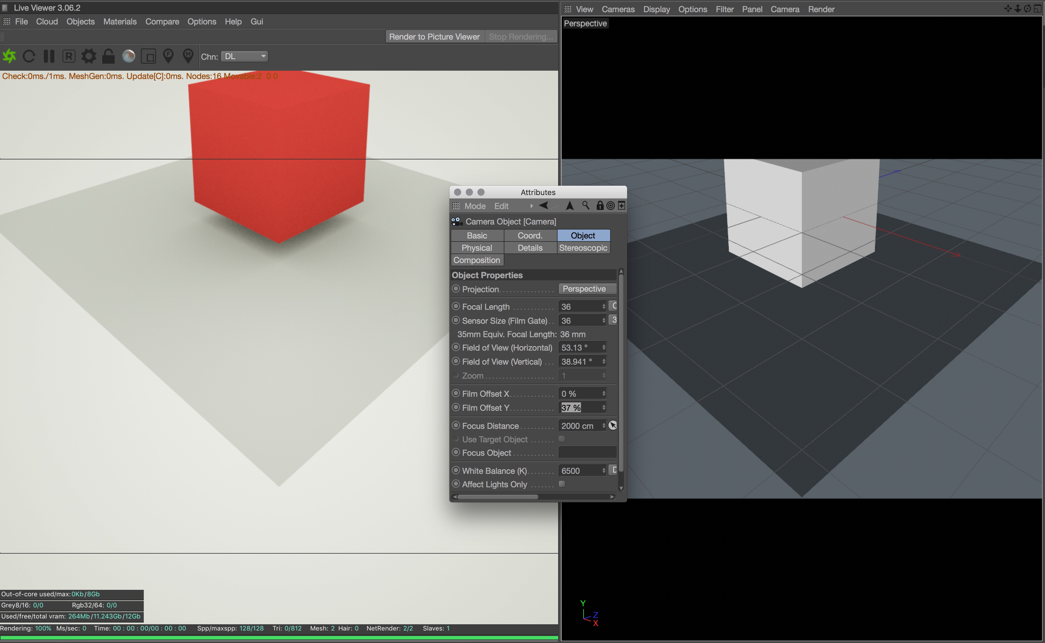

When using camera offset the Editor view and LV do not match (LV often has too much offset compared to Cinema's editor)

To me as far as I was playing with the film offset in the camera settings produced this result.
This effect (from my limited testing) only occurs with the Film Offset on Y and is not present with horizontal (X) offset.
Using the lens shift doesn't produce this effects simply because the effect is completely ignored by the editor view.
Hope this helps.

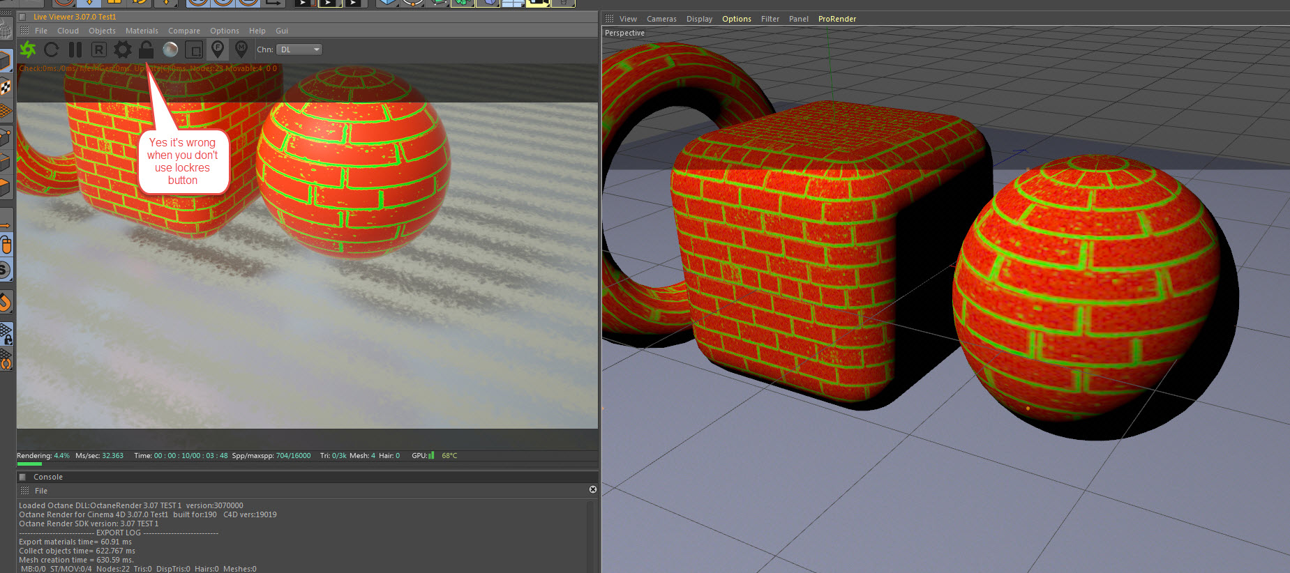

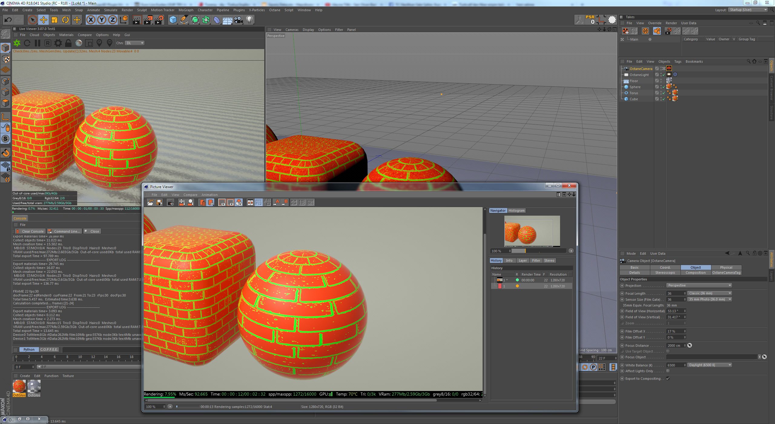

Well. Understood why it's diffent. Actually it's not a wrong calculation because offset values are correct. But Y size of rendering is bigger than viewport. It requires a revision on LV with unlocked resolution.

Sending picture will help always. Could you please figure it by images+scenes what we are talking about exactly as my picture?sdanaher wrote:Reviving this issue as its causing huge problems on our current print prodution and its still not addressed (thanks dotjack for posting the example!)

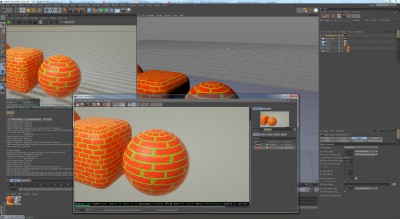

Sorry attached wrong picture. I'm answering a lot people at same time. Here's correct one.sdanaher wrote:Very cryptic... I have no idea what this pic is supposed to be.
Is this any clearer?
