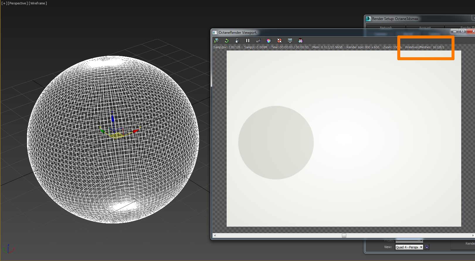

Today, I did a quick test and noticed this using a simple sphere:
The raw sphere geometry is 16, 128 polygons. I converted to an Octane Proxy and activated "moveable proxy" under Octane Properties. Why does it still show as 16, 128 polygons?

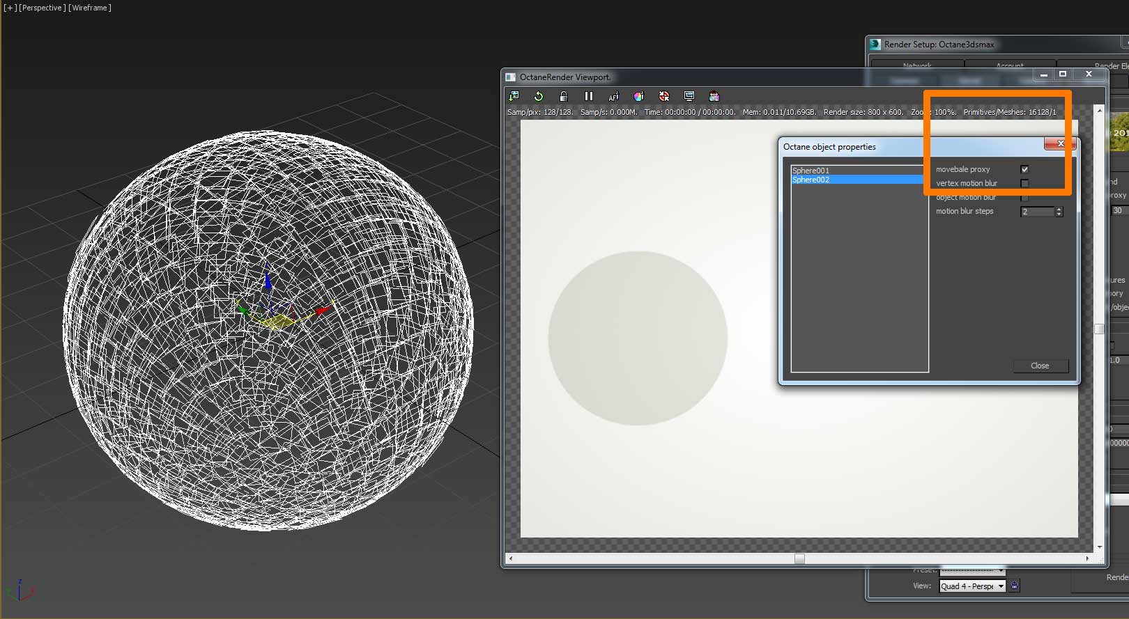

Sphere geometry
Sphere geometry
Sphere proxy
Sphere proxy

Just to clarify, what happens when you introduce two or more instances of the same object. If you try creating multiple instanced copies, you should notice little to no increase in the poly count total as the number of objects increases.

azen wrote:Hi,
Right, when I instance this sphere, the poly count does not increase.
Do I assume then, that only the first proxy is counted?

Olitech wrote:
azen wrote:Hi,
best,
O
Correct. This allows for considerable savings on memory when wanting to render scenes with a high number of duplicate meshes, like vegetation for instance.
