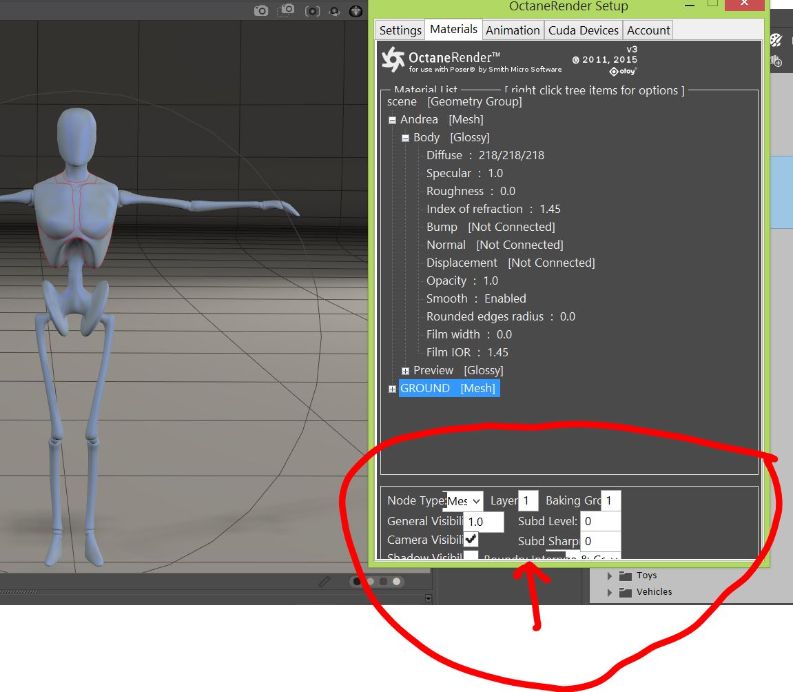

I wonder if it may be related to another issue I noticed with the bottom of the menu box being partial cut off, resizing the box does not help either. {Please see screen shots}

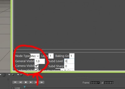

Screen shot of the node graph box, it is un-tick able

I also just noticed I am also unable to un-tick the some of the other boxes as well (Camera Visibility, Shadow Visibility, etc.)

Try changing your windows font size to 100%. Looks like yours is at 125 or 150%?

The resizing worked! You are a genius! Thanks for the fix.

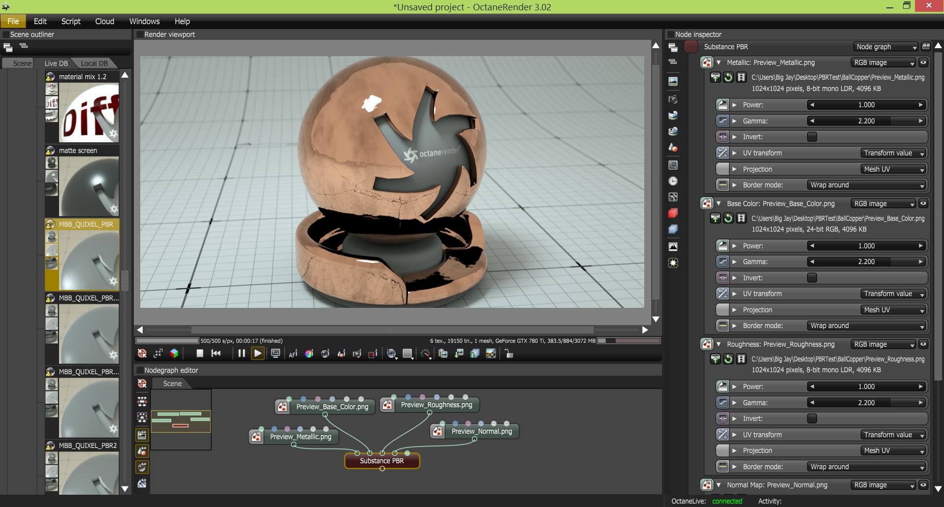

Ah, I see. That's what I was looking for, I was unaware I could paste a node into the Poser Node Graph.
I copied the " Substance PBR" node from the Octane Stand Alone and pasted it into the Poser Node Graph.
It gave me all the correct material types to connect to, I set up the materials accordingly, here's a side by side screen shot of the results.
Not bad, I wish there were more surface detail like in the Substance Painter Render, this was about as close as I get it to the original. (Rendered in the Poser Octane Plugin)
