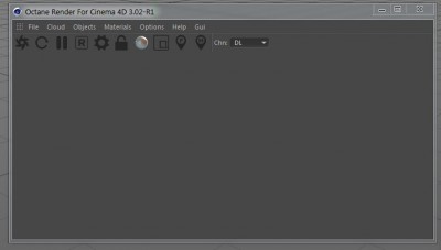

I'm new, not previously used octane
Constant error
Using version 3.02, I have no problems. Since it does not require authorization.

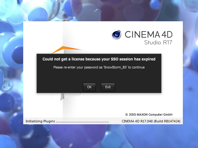

I'm using Windows 7 64 bit

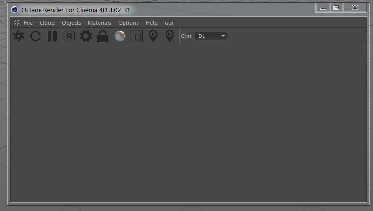

Any help
Thank you :)

This is a known bug we've fixed and will be included in the next release.
In the meantime, in order to circumvent it you may reset your authentication data by manually deleting this file:
%APPDATA%/OctaneRender/otoy_credentials
Apologies for the inconvenience.
